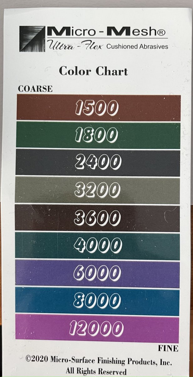

  1. Many of us have used the Novus #1, 2, and 3 to polish acrylic domes. Great products but #2 (the fine one) still leaves very tiny but visible scratches. What grade abrasive would correspond to #2 Novus? I have a set from Micromesh going to 12,000 (see chart image) but I'm not sure where to start to improve from Novus #2. Questions to Novus have gone unanswered.

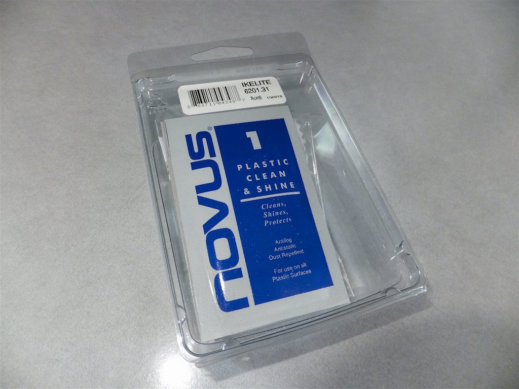

  2. I have a novus kit and i have the 3 the heavy scratch remover, 2 fine scratch remover and 1 plastic clean and shine. So three types of scratch remover in kit.

  4. Thanks, yes, I have used 3, then 2, then 1 (I read the instructions). I'm hoping to learn without trial and error how to improve on the results left when #2 is thoroughly used and #1 does not improve it from there.  Yes, I'm being extra fussy, because I have the polishing tools now to go beyond.  I guess I can try 6000 or 8000.
