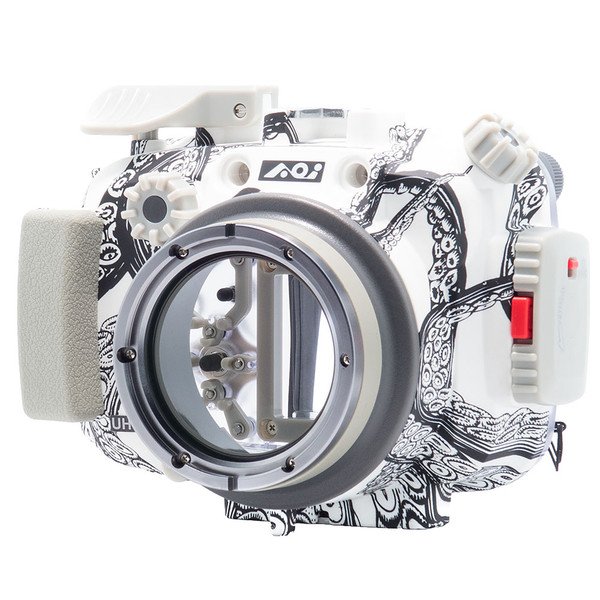

    For M43 with the 14-42 power zoom AOI offers a port that works with the 67mm bayonet mount for WWL-1/1B or the AOI UWL-09 Pro water contact optics.
