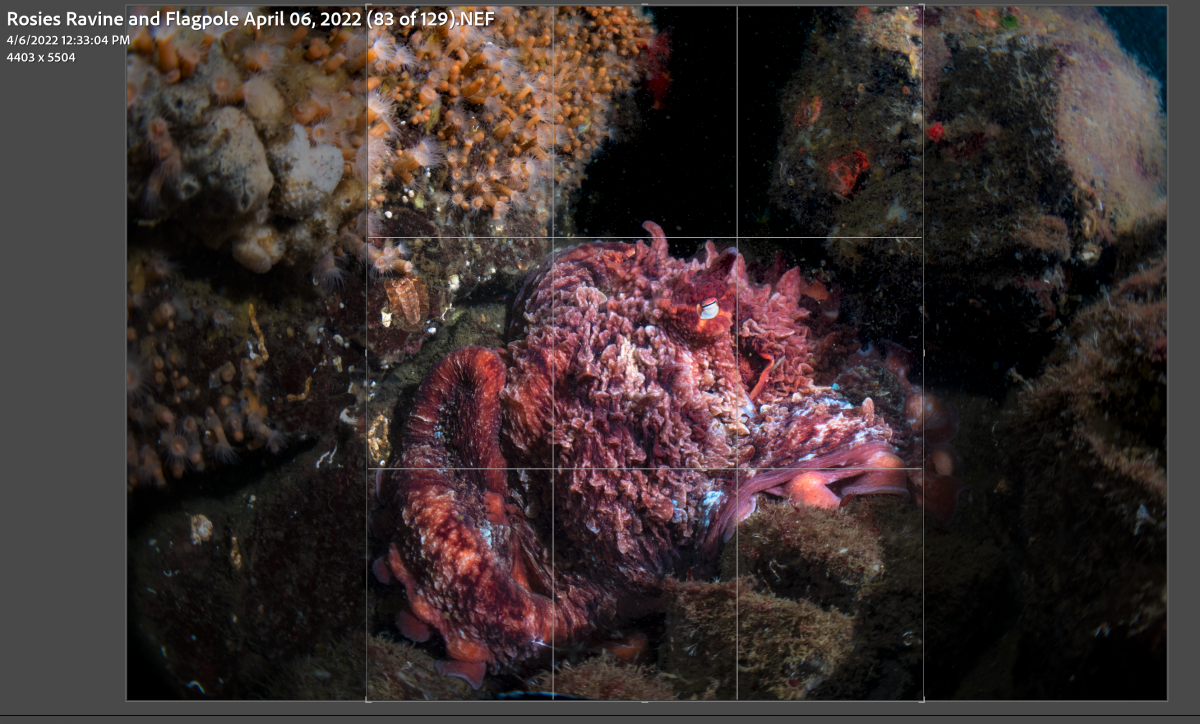

  4. I am mostly using SuperResolution or Topaz Gigapixel for images that I have cropped significantly from a D850 image. For example, I might take a landscape image and crop it to portrait and then upsize. Making 8x10 portrait crop drops from 8200 -> 4400 pixels wide. You lose almost half the pixels.
    Below is an example of an image of a Giant Pacific Octopus I took last week at nearly point-blank range crammed into a crevice. There was no way practical way to turn the camera sideways in this position. I wanted to use this image in portrait mode for a cover shot so I cropped it 8x10. SuperResolution returns it to 8800 pixels wide.

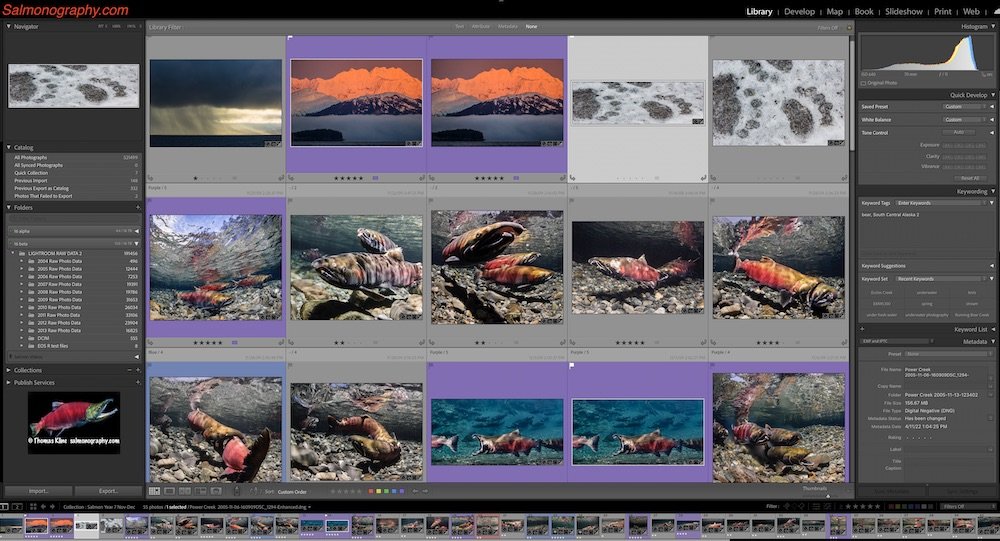

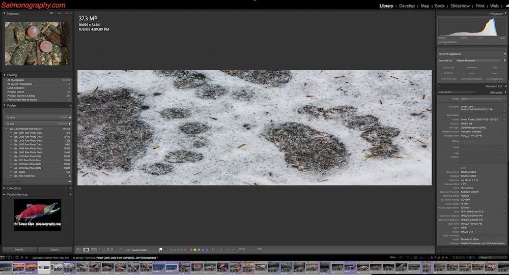

  6. It does not work so well with Nikon D1x files because of the asymmetrical pixels, ROTFL. Here is a screen shot from an early version of my "Salmon Year" slideshow in LR. You can see a few doubled images in the filmstrip where I did some supersizing (my preferred name; Adobe should call the button "supersize me", ROTFL). Note the highlighted image in the filmstrip and the one to its right (it is not narrow as the shot was taken looking straight down). I took this shot in 2005.
    I added a second screen shot in grid view to make this clearer. The two other supersized pix that you can see in the grid were shot with the D2H (a 4 MP camera).
