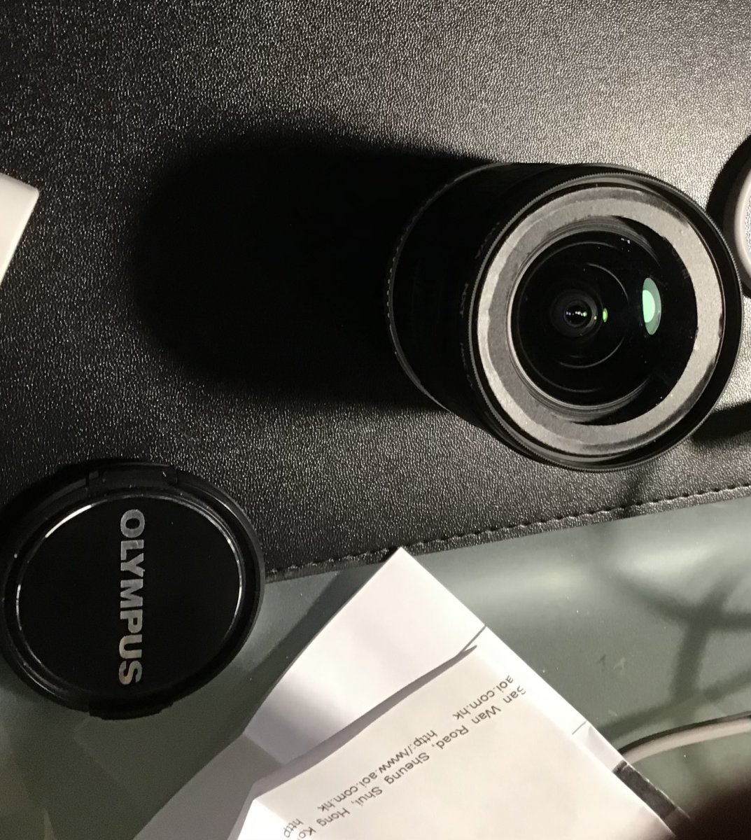

  4. I was impressed as well from the pro lens sharpness but I could not afford the weight and cost so I decided to go with the inon 95.
    Not impressed by the quality but might be my capabilities the real hinders. I gained the fov but not the sharpness I wanted. Anyway I was told that there are no compact alternatives.
