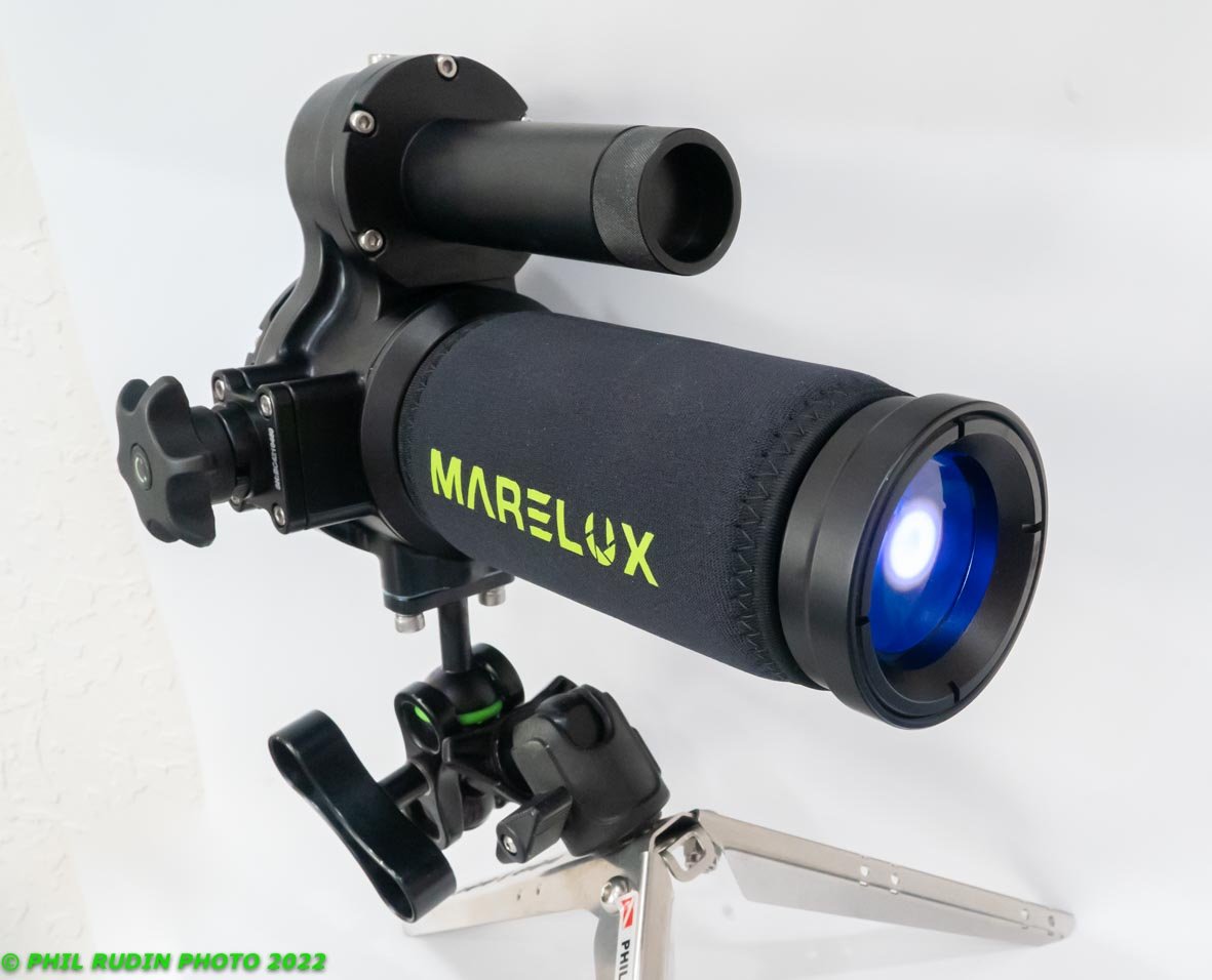

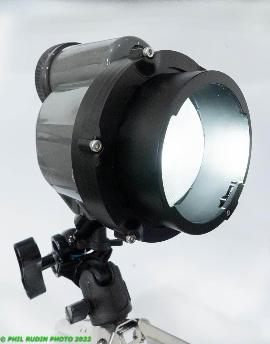

  10. well, i got it.  Its big and heavy but seems solid.  Just because I mentioned it above - there is a quick disconnect but you will definitely not be disconnecting it during a dive.  It is so big and heavy that you have to use the ball mount on the snoot, which means your strobe wouldn't be connected to anything if you disconnect the two.
  11. I have the Marelux SOFT (Smart Optical Flash tube) in house for review and I have not been in salt water with it yet. These are some of my observations so far. First I have the "dock" for the Inon Z-330 strobes which threads onto the flash in the same way as the shade so it is very secure and I have no fear that the strobe would fall off if the SOFT is mounted to the flash arm. In the attached photo you will see that the dock extends well beyond the  flash head. This extension narrows the beam in much the same way as the Retra reduction ring accessory does. When the SOFT is mounted to the dock and locked into place the configuration of the flash tubes should have little effect on the quality of the light output. I suspect the result is the same when using any of the other docks for strobes like Retra, Sea & Sea and others.
    The focusing light requires a 18650 battery which adds to the weight of the system. My review unit arrived with a neoprene cover on the tube which will I guess offset some of the negative weight while in the water. I am not sure at this time if the cover is an option or ships with all units.
    The focus light works well unless you are in bright ambient light. The small 2mm diameter end of the range at 170mm will of course be dimmer than the 30mm end at the same distance. I like using the snoot on a small tripod which makes it easer to keep the light where you want it on the subject. As you can see from the attached image the balance is much better on the tripod using the ballhead on the SOFT rather than using the one on the flash.
