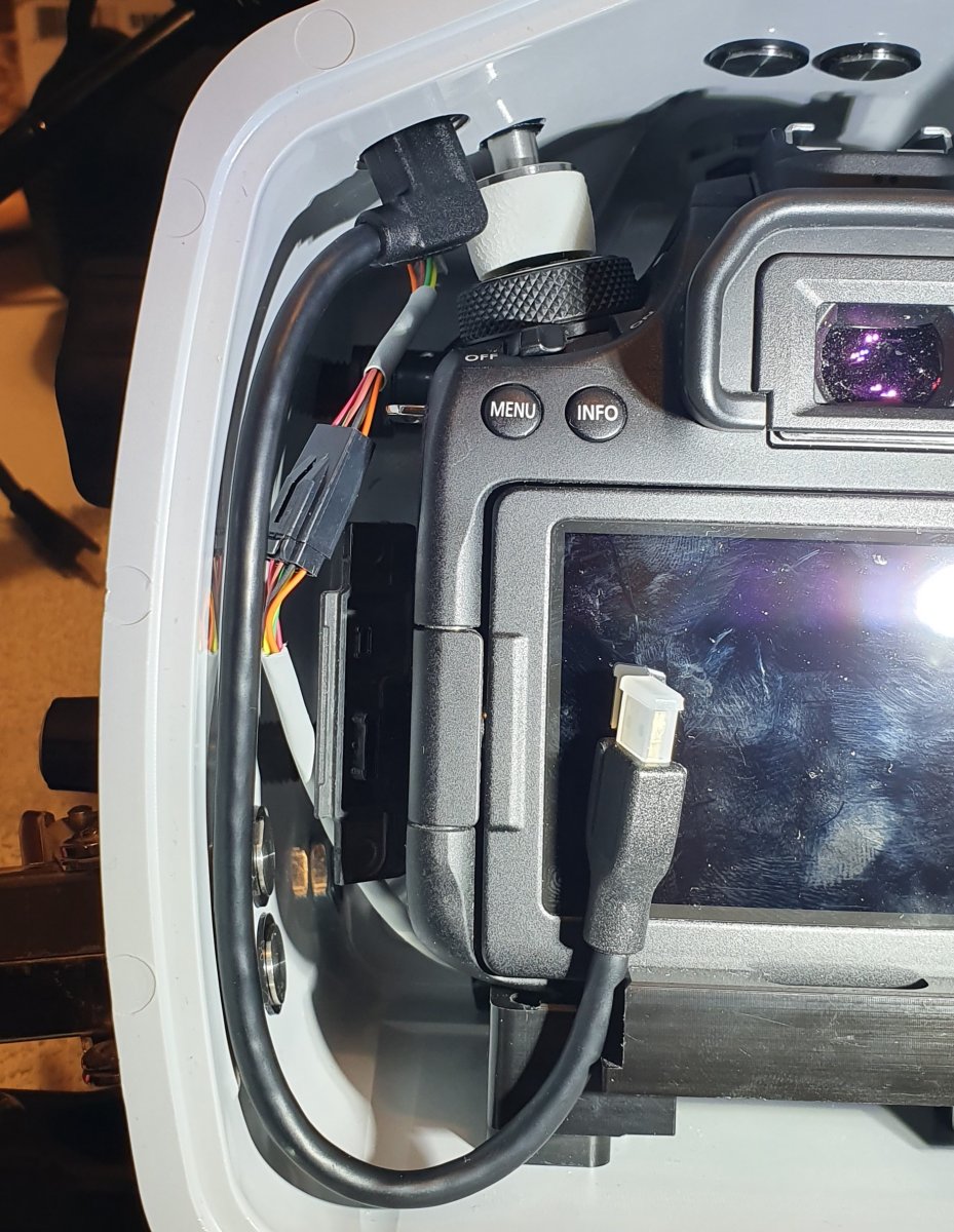

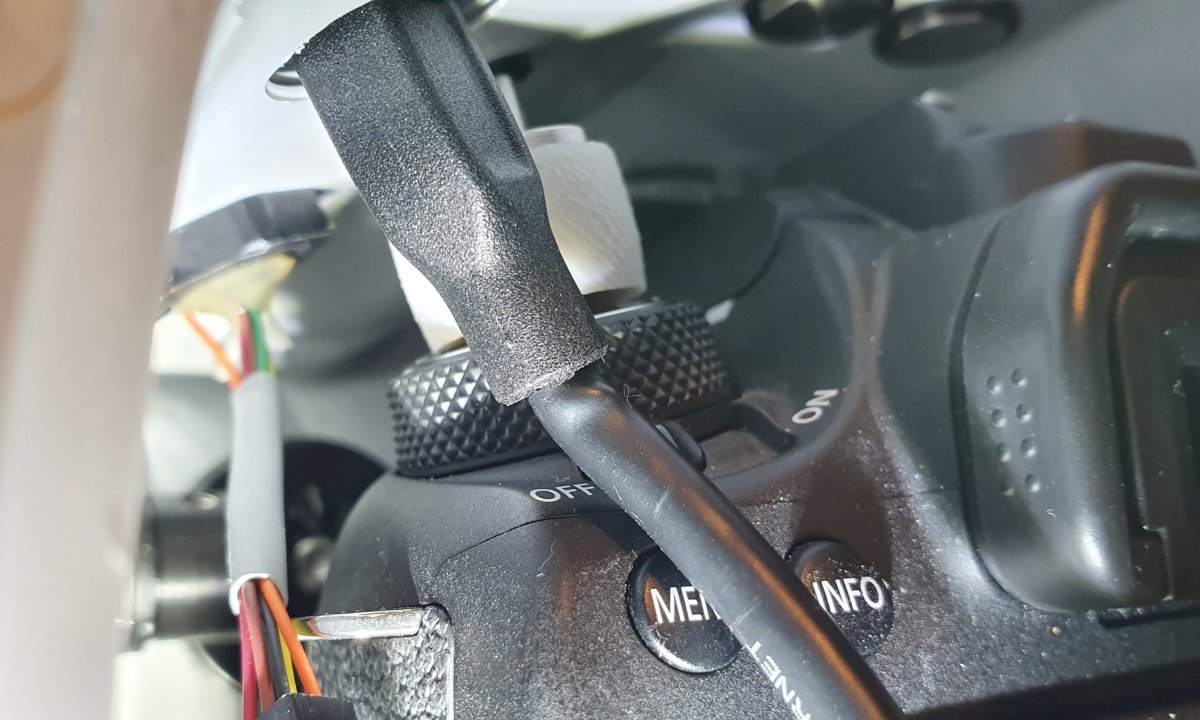

  1. I would like to use Nauticam Shinobi with my Ikelite 200DL Underwater Housing for Canon EOS 90D DSLR.  I installed Nauticam M16 Standard HDMI Bulkhead but I can not connect camera to the bulkhead inside the housing with the HDMI cables that are provided with the Nauticam housing. If I use "I" shape micro on the bulkhead, there is no space as it is going over camera controls (see photo). The second cable is "L" shape micro - that fits perfectly, but on the other end of the cable is also micro connector, and I need mini "L" connector. Is there any suggestions. I have spend 1 months looking for appropriate cable on the internet!  Ikelite does not have suggestion.
    best regards, ante
