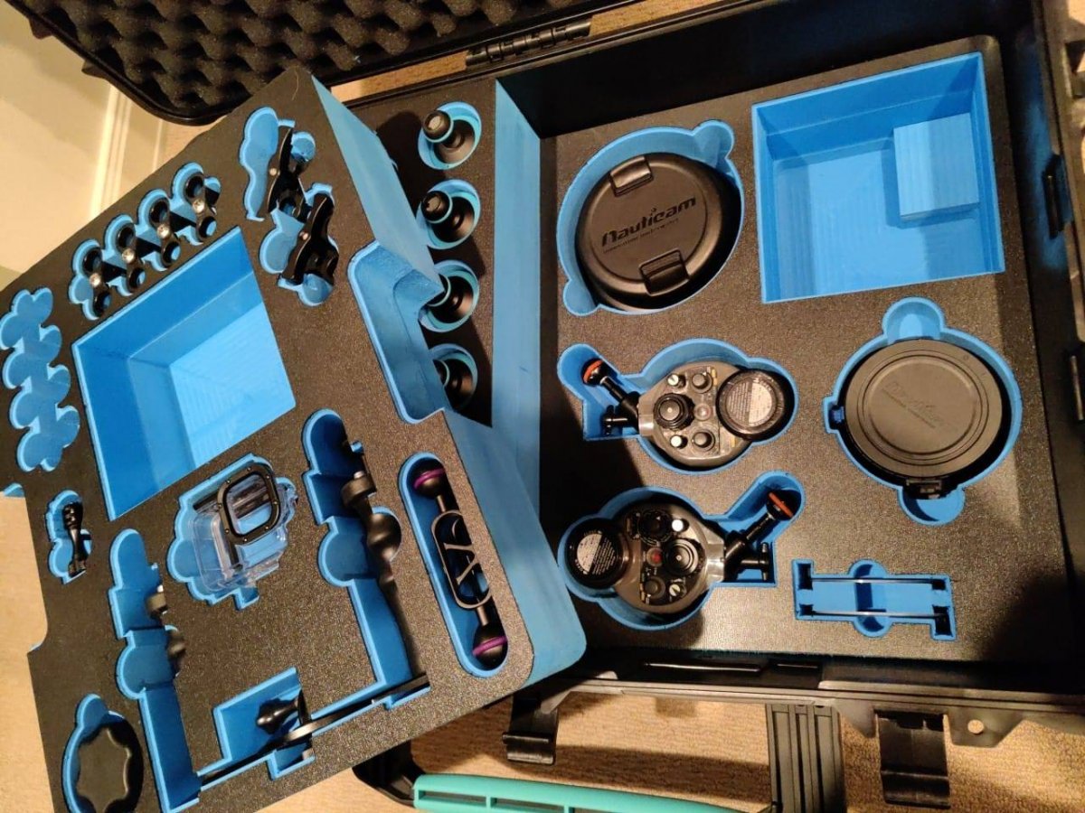

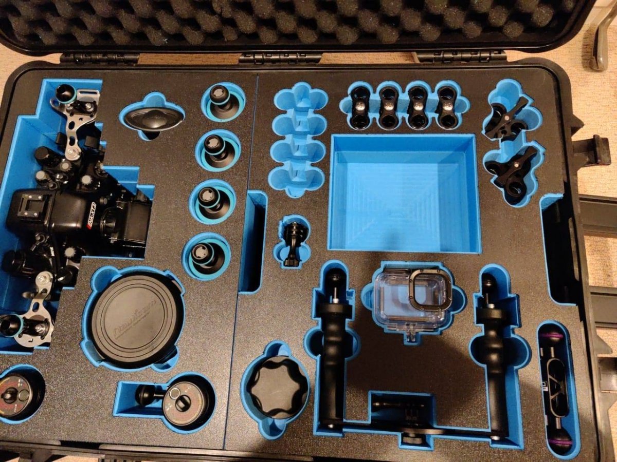

  1. Heading off to Beqa Lagoon Resort in Fiji this weekend, and picked up my equipment case with new CNC cut foam inserts just in time!
    The open square areas I'll use for assorted small stuff like strobe cables, spare orings, grease, chargers etc.
    The case is a HPRC 2760, which is exactly 158 linear cm (62 linear inches) so is as big as a checked bag can get with most airlines before being considered over size. By the time I add in the extras, it'll probably end up around 23-25kg, which falls under most (but not all) airline international check bag weights.

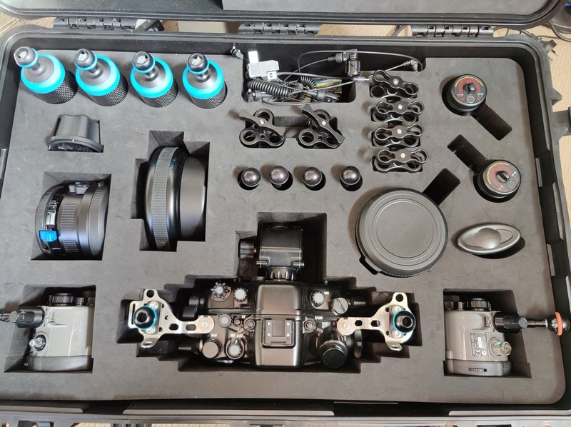

    Much better than the previous effort from a different supplier, who found it too hard to do a two-layer fit out:

    First thing I did was set up a tripod looking straight down, then took photos of each piece of equipment, getting pics showing the front, side and top of each piece.
    Then brought them into a photo editor, and scaled them to the right size. Created notes about my preference on how to store them, or how many (eg, multiple arms, clamps, strobes, etc), and created a PDF with all items scaled and measurements marked.
    Then placed them all how I thought they could fit onto the right sized template.
    Then sent the place a PDF of everything, got a quote, then actually left all the gear with them. They double checked all my measurements, and designed it all up in CAD, then cut it all out in a throw-away cheap foam to check tolerances, adjusted CAD and then cut it for real.
