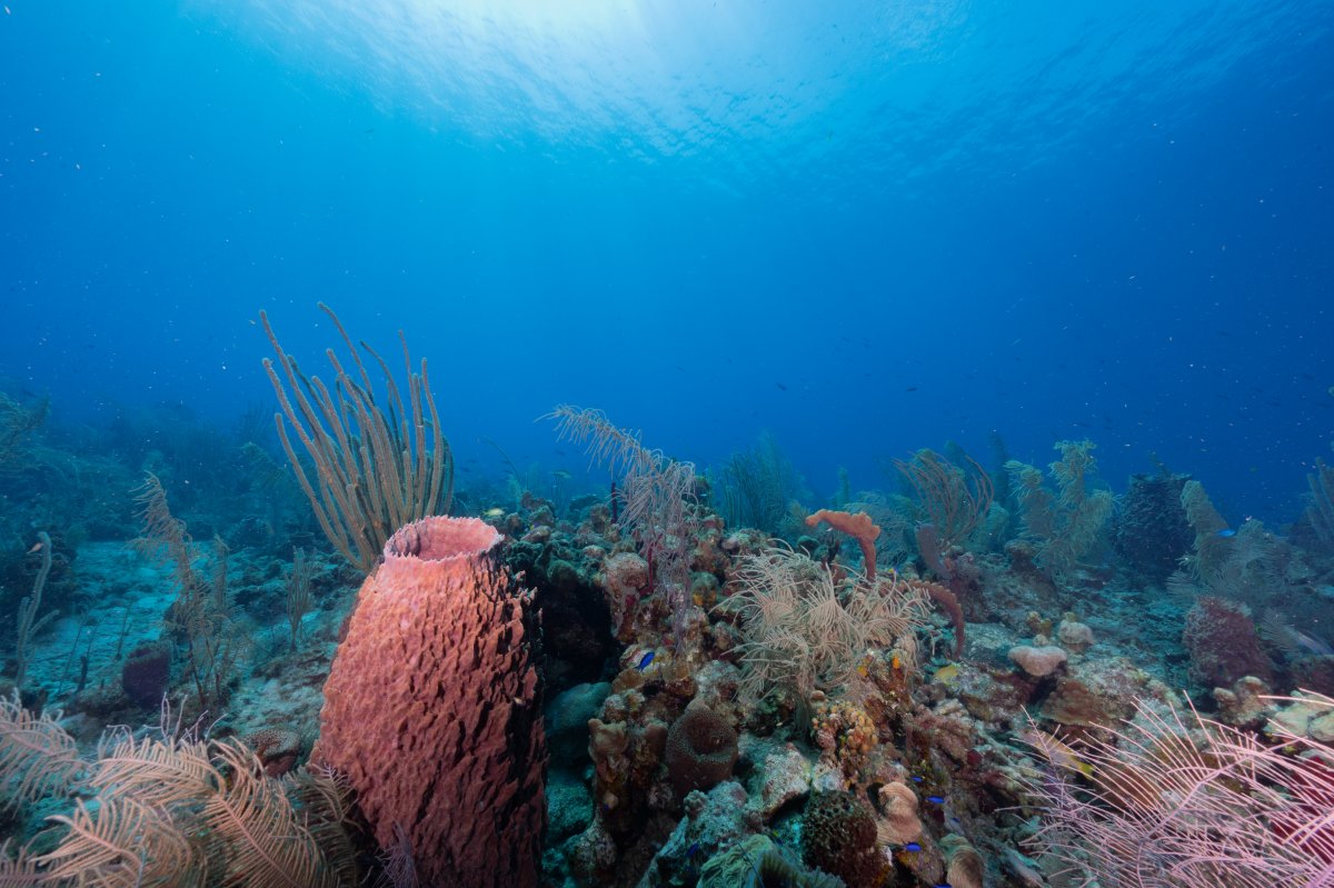

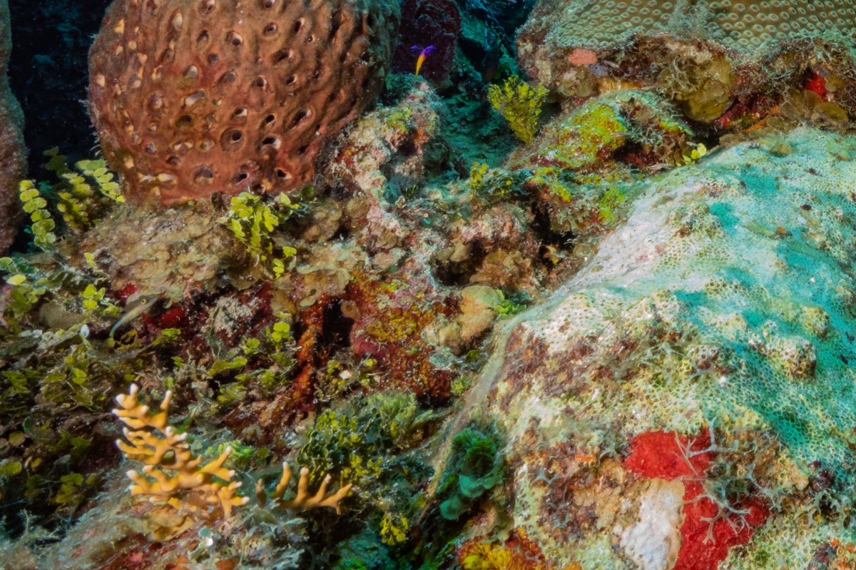

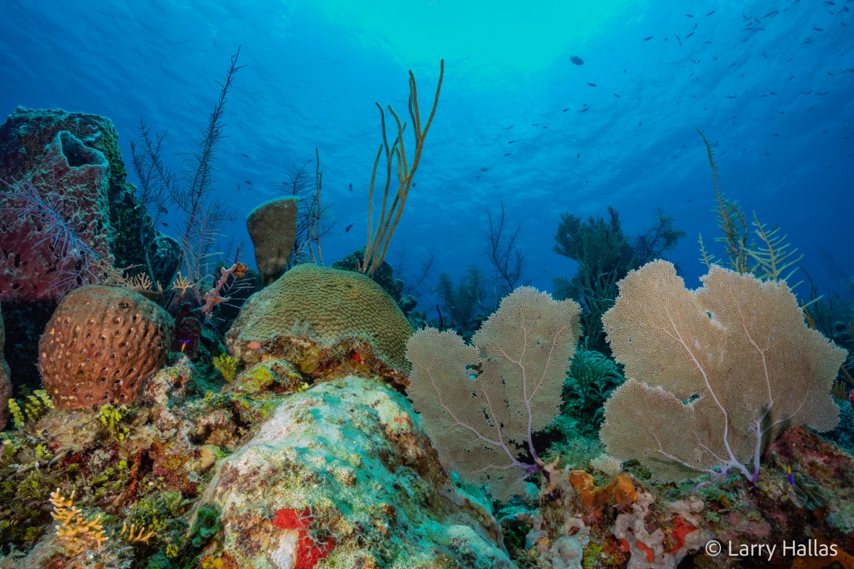

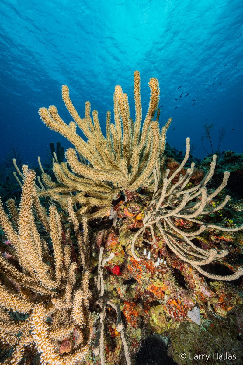

  1. As promised, I would like to share the results of adding a Sea & Sea M82 Internal Correction Lens to my Nikon Z 14-30mm behind a Zen 230mm glass dome port. I had to adjust the Distortion slider in the Lens Corrections in LR to between -30 and -50 to fix the distortion in the corners, but the corners are reasonably sharp. The corners look 100% better with the S&S Correction Lens after adjusting the Distortion in LR. Here are some sample photos @ 14mm, ISO 800, f/18, 1/125sec

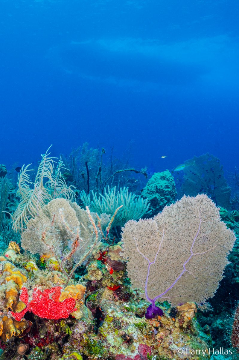

    Before using the S&S Internal Correction Lens the corners of my wide-angle shots with the Nikon Z 14-30mm rectilinear lens were blurry, even with a 230mm dome and stopped down aperture (f/16 - f/18). From what I understand the S&S Internal Correction Lens helps the lens focus closer and bring the corners into focus, but not like a diopter because you keep the same FOV (maybe the experts can explain this better). Unfortunately, the S&S lens attaches to the front filter threads of the Z 14-30mm behind the dome port so it cant be removed for a before and after comparison shots. Here is an unprocessed export with the Z 14-30mm and 230mm dome without the S&S Internal Correction Lens and you can clearly see the blurry corners in the coral (you can also see the distortion)

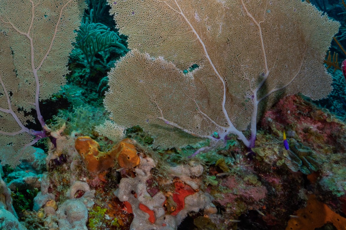

    Any chance of a blow up of a couple of the corners of the landscape image with the two gorgonians on the right-hand side?
  5. Hi Tim,
    Here are the corners with the two gorgonians on the  right-hand side. It's not perfectly focused but I am happy with it.
    Larry
    Edited by UWPics
