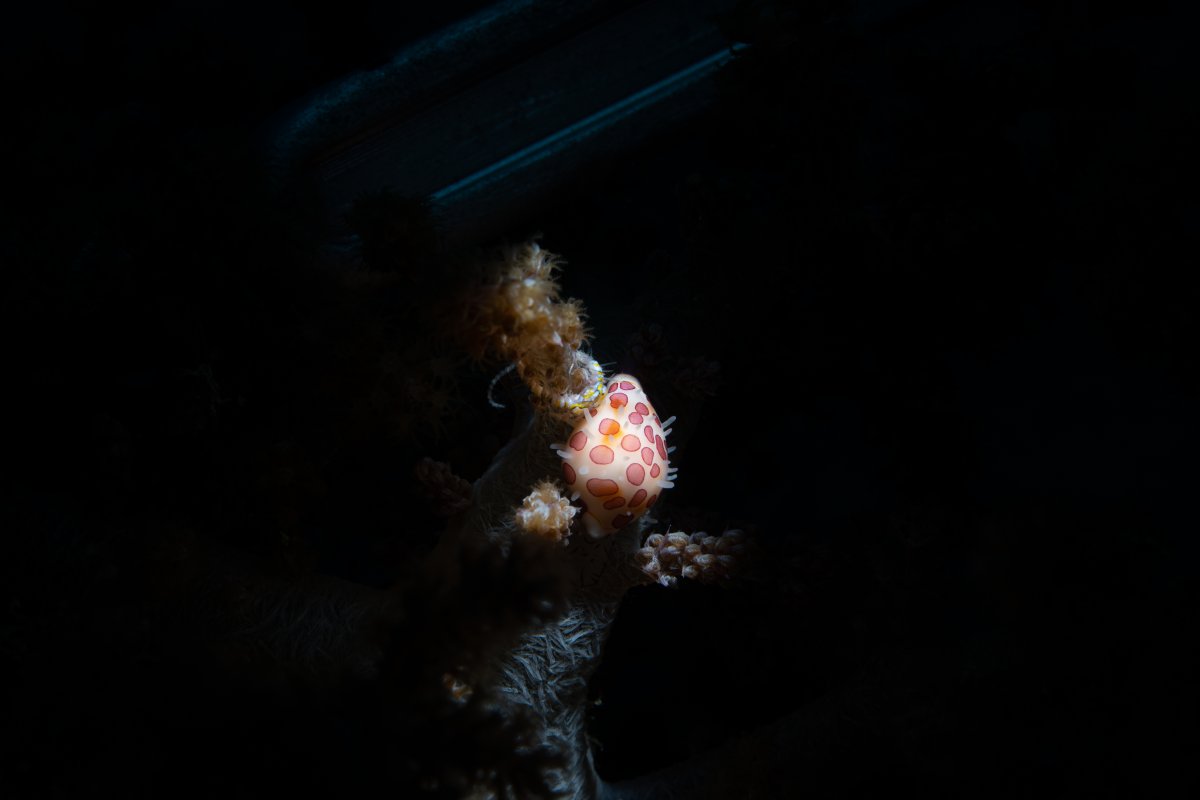

  9. Thanks for the tips everyone, glad to see I'm not the only one who struggled with this in the beginning. I guess there are no shortcuts (private snoot holder aside) and nothing beats practice. I do wish I have more than 2 hands - my left is usually holding the muck stick in addition to the camera handle hence why I find it really challenging to use it to adjust the snoot without losing the position. I'm definitely not perfectly still without the muck stick and am taking GUE fundies when I get back to try to improve that. Today I decided to try inward lighting after reading Alex's book again last night and couldn't get it to work easily either, so I guess I just need to practice more and force myself not to give up too soon by not taking my other strobes...
    Below is my one and only successful snoot attempt - after 2 dives!414387164_Dive13ElPinoy_May032022_DSC05145_v2.thumb.jpg.d85c444023dbbdfc27f4f96098ca53d5.jpg

    Ahhhhh, you have hit an important issue there: muck sticks. Some years ago I managed the dive operation at a resort in the Lembeh Straits of Indonesia. Superb muck diving territory. We made a healthy profit out of resort-made muck sticks. But, honestly, they were the bane of the operation's life. In a very fragile eco-system and where the silt from a stray fin-kick spoiled many a photo, muck sticks were a poor substitute for really good buoyancy control.
    The pic you posted shows you are definitely getting there. I'd suggest that in early snoot days, one decent pic out of two dives isn't that bad! Keep going..... don't give up.....
    ... and get rid of the damned muck stick and REALLY fine-tune your buoyancy. You then have two hands and, I promise you, your ability to shoot snoot shots will change significantly :clapping:
