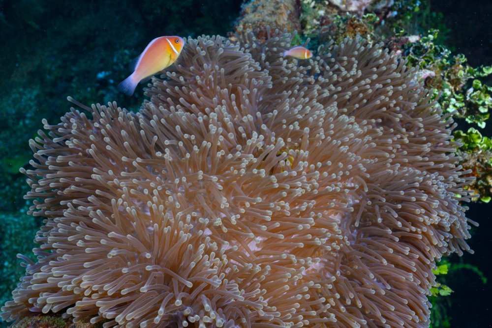

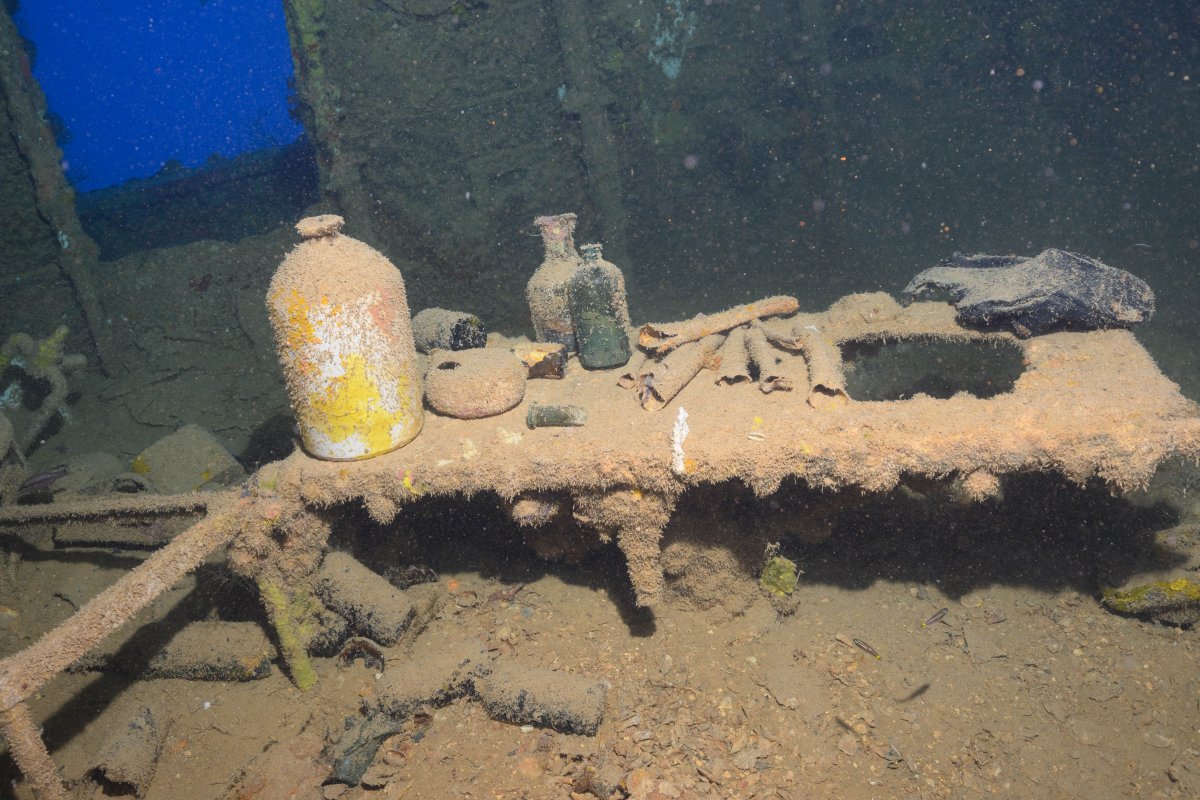

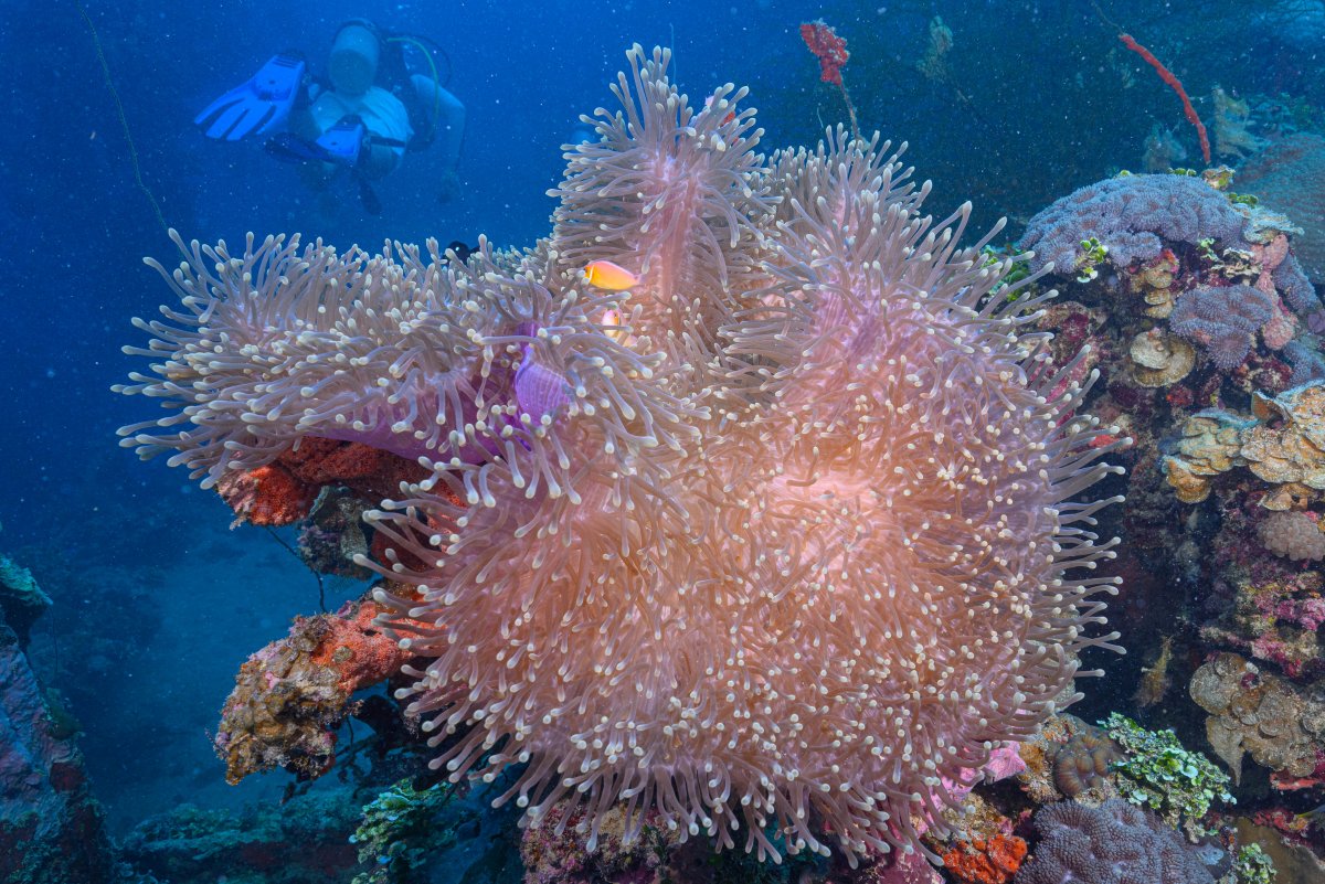

  4. I've now added 16 dives in Truk to the Z9's list.   I shot all wide angle with the 14-30, S&S IRC, and 230mm dome port.   Mostly at F8 and ISO 500. I used 3d tracking exclusively, and it was never an issue to get it to work.  It's like the D850, except it doesn't feel like a D850 if that makes sense.  Anyway, AF was quite reliable when I did my job.  A few times it missed focus, and I must have tripped the shutter before AF finished.  Mostly it stayed right where I wanted, even with focus-and-recompose.   There were times when I got close to a large anemone and could drop the ISO to 64 - the results were gorgeous.  Zooming in one one at 100% immediately showed a circle of 6 Pedersen Cleaning Shrimp in the anemone.  The 14-30 at times was beautiful from edge to edge, and at other times seemed smeared in the corners.  I think, at the wider focal lengths, the out-of-focus plane in front (of the focus plane, nearest to camera) seems particularly bad, which means I probably need to change my focus point closer.  It's a better lens if you don't have anything in the first 3 feet of you when focusing on a wall 10 feet away.
    One thing I made much more use of was changing ISO.   Particularly going inside the wrecks I needed to boost ISO (to 1000), and back outside I was blowing highlights at 500.  With the 3.01 firmware I was able to remap the ISO button to Fn4 so it was right under my left thumb.   Made it far easier to change than reaching over the camera with my left to spin a dial while my right was holding the ISO key down at the same time.
    In post-processing the images, I'm seeing essentially D850 images.  They are stunning at ISO 64, but it's easy to blow white highlights at ISO 500.
