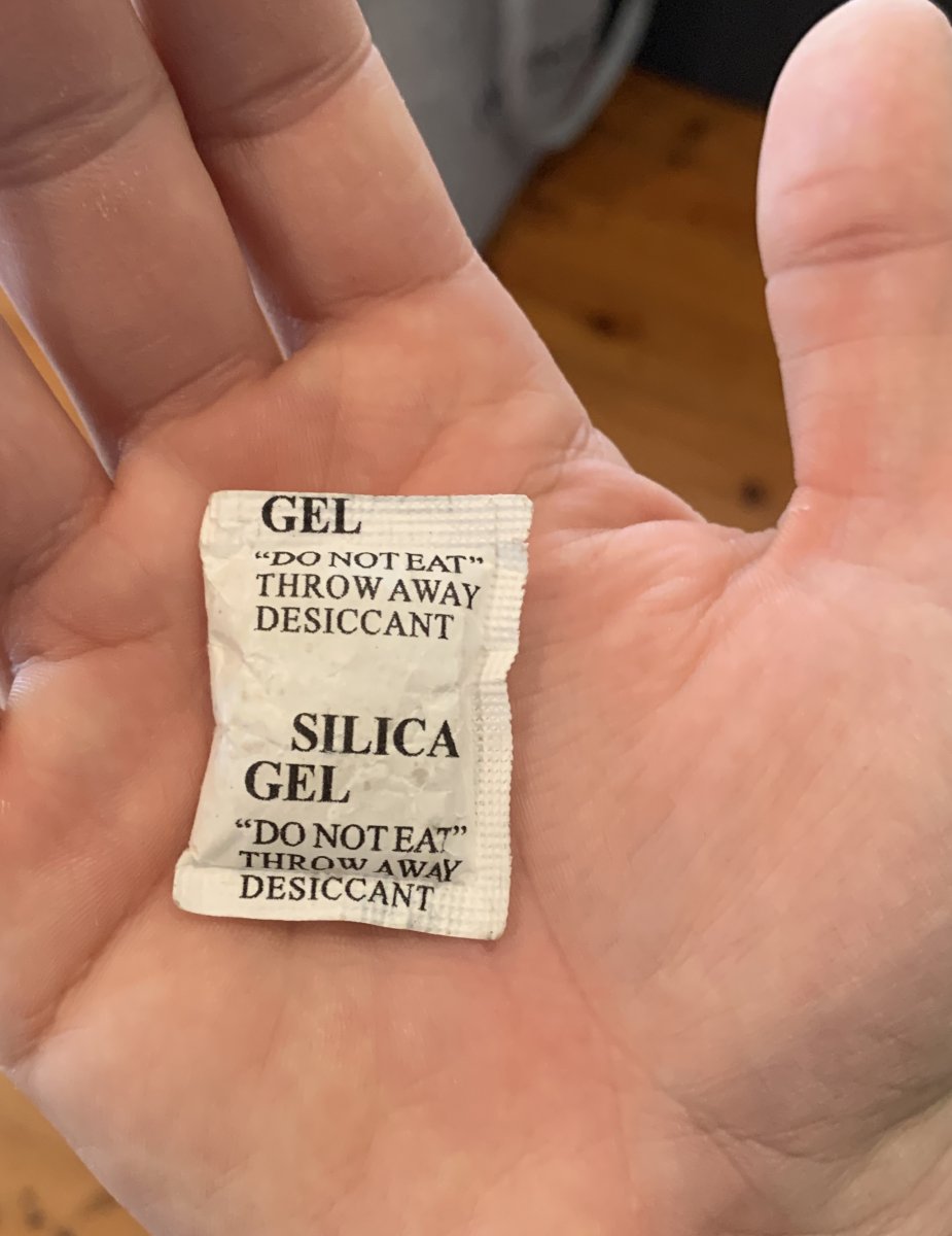

  1. Hi eveyone,
    Like many of you, for many years I have stuck a pack of silica gel at the bottom of my housings, to prevent condensation issues.
    This has seen me condensation free for 10+ years, including diving in tropical places (with/without air conditioned closing of the housing), and temperate areas in all seasons.
    My longest-lasting silica gel pack is the one pictured below, which I must have got in a shoe box, it has sat in my Nauticam D500 housing for the last 6 years (and I can't remember, perhaps it was in the previous housing already).
    Anyways, yesterday I opened my housing, to find my D500 DSLR and the parts of the housing covered in condensation!!!! What's weirder: I had put back the camera there so that it's would be ready for next dive (I find my housings the safest place to store DSLRs when not in use), and it had been sitting there for the last 2 weeks, the housing itself was sitting on our laundry room, which is slightly moist, but hey, it's been sitting there for many years. Noteworthy: I had NOT vaccumed the housing that time.
    I tried everything, found the desiccant pack very moist, so it was time to dry it up and rejuvinate my silica gel. Googling the best way to do it (oven, microwave...) I realized that:
    1/ there isn't much good guidance available online. Most of the articles refer to free-flowing silica crystals that you can look at (colour change indicates if they are saturated in water or not), the idea being to pack them in a box, in one's camera bag. But these boxes are too big to fit in our housings :)
    2/ I am still unclear why that condensation formed at home. INTERESTINGLY I've read somewhere (can't find the link anymore...) that saturated silica crystals (having absorved the max of their water capacity) may release that moisture on their own, without heating. Could it be that my silica pack went on strike and tried to flood my housing on land?!?
    All-in-one, I am curious what you people do to keep your silica pack doing it's job?
    If you do use paper silica bags like I do, how do you heat them up, how do you know when the crystals are dried enough? (apparently, if you heat them up too much, you may impair their water absorption capacity).
    Have a great day,
    Nicolas
  2. I've never used silica gel packs with my Nauticam housing and have never had a condensation problem - in the tropics or otherwise.   Sydney would be a great candidate for that to happen - Hot humid day in November then jumping into water that is still only 16°C.
    The capacity of those small silica gel packets is very limited and they are only able to keep the housing dry while it is sealed.  If you leave it outside the housing for a few hours or so it will be saturated by atmospheric water.
    If the packet contains 10 gr of silica gel, that can carry about 3 gr of water.  Assuming a 3l internal housing capacity, that would be about 0.025 gr water at 50% humidity so can absorb the water from the housing about 100 times - assuming it is never stored outside the housing.  The actual capacity is probably less as the absorption slows down as the gel is approaches capacity and you pack might only be 2-3 grams?   It will reach equilibrium water content in about 6 hours outside the housing.  All this assumes it is fully re-generated when you take it it of your shoe box which would only be the case if it was sealed inside a plastic bag when it arrived and the shoes release no moisture.
    As to why it condensed inside - first your silica gel was most likely exhausted when you closed it up and has been for some time, possibly inside a warm room inside then you put it a cold laundry room.  I don't believe silica gel gives up it's moisture unless you heat it.
    If you want to work out how long to heat your silica gel get some indicating silica gel crystals, they change colour when re-generated, otherwise you are just guessing.  You would need to find some sort of porous container to hold the beads that you could pull out and re-generate.
    Have a look at this link, you'll see the capacity of the satchels  yours looks like it might be a 2-3 gr satchel by dimensions.  The 2 gr satchel is recommended to protect 1.5l of enclosed space - keep in mind this is designed for once only.  You put a fresh pack into the space and seal, the package gets opened by the new owner, the desiccant removed and is thrown away - this is the design case.  This indicates for you use case - the housing you put a fresh desiccant package in each time you use it - You probably should be re-generating the pack every few dives.  https://www.silicagel.com.au/silica-gel-packets
