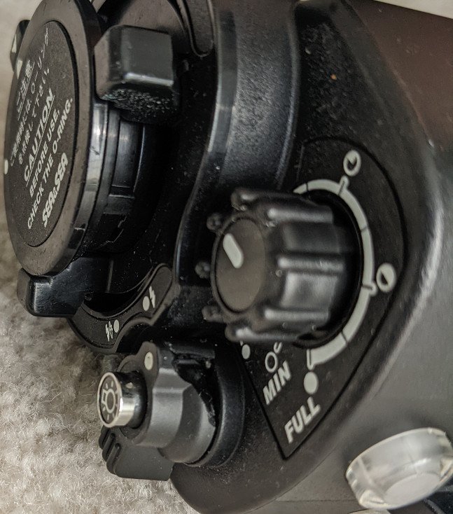

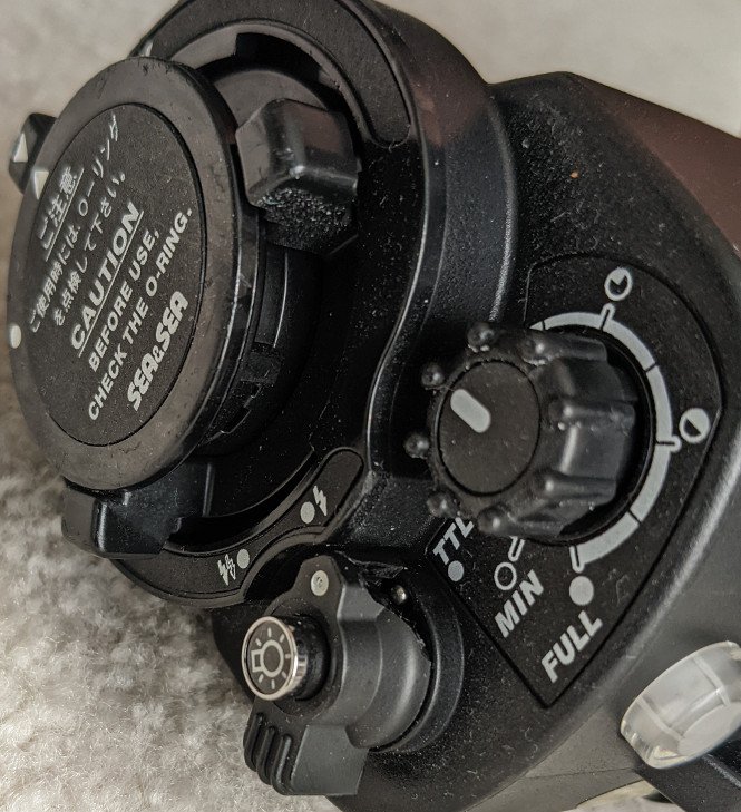

  1. Looking for opinions, i have a S&S YS-01. Has worked well enough for several years. Before a dive earlier this year I noticed the mode knob on the back wasn't turning/stoping well which led me to discover a crack/break while articulating it.  I'm wondering if anyone has recommendations on what to do: send it off for repair or toss it/sell as damaged?
    Any ideas on how much they charge to service this stuff?  I'd be inclined to try and repair this myself if i could get parts.
    No other issues that i know of and it has not been flooded. I tried asking the auth service companies (Backscatter/Pacific Housing repair) for guestimates on cost (not formal quotes) and was completely ignored. They all want me to send the strobe before they will offer a quote. So IMO, I need to either commit to all the shipping and repair, whatever it'll cost, or just get a new one and not waste the money in shipping. IMO, not sure it's really worth it if the total is well over $100 since i've seen these used for $200-250 on occasion.

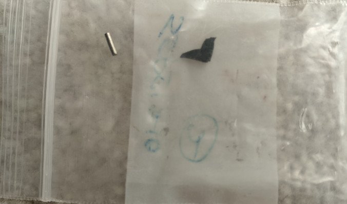

  7. @Kraken da Mabini, i'm often leary about gluing since my track record of glued things lasting is very not good. I mean, i guess there may not be anything to lose as long as i don't do any more damage but i really don't have high confidence - especially when there is pressure internal to the knob (some that keeps the knob in a position and the rollers that let it turn - i think).
    @phxazcraig, no. I discovered the hairline crack between dives as I was articulating the knob and it turned too far - the mode position stopper didnt work. I'm guessing it came from being dropped on the table by the crew after the previous dive. Anyway, as I was playing with it trying to see what was wrong the plastic piece completely broke and a roller came out.  As it is, the mode doesn't change as you turn the knob, so it is non-functional even if it wouldn't end up flooding or causing any other damage to the strobe. Prior to this, i've had zero problems with it.
    @Tinman, understand and agree. But i wasn't so much looking for a quote, just a WAG. See above for my concern about gluing, but maybe it's worth a try? i guess? I'm not all that attached to the YS-01 but I was kind-of hoping I could keep the strobe for a second 'generation' and just replace my old camera/enclosure.

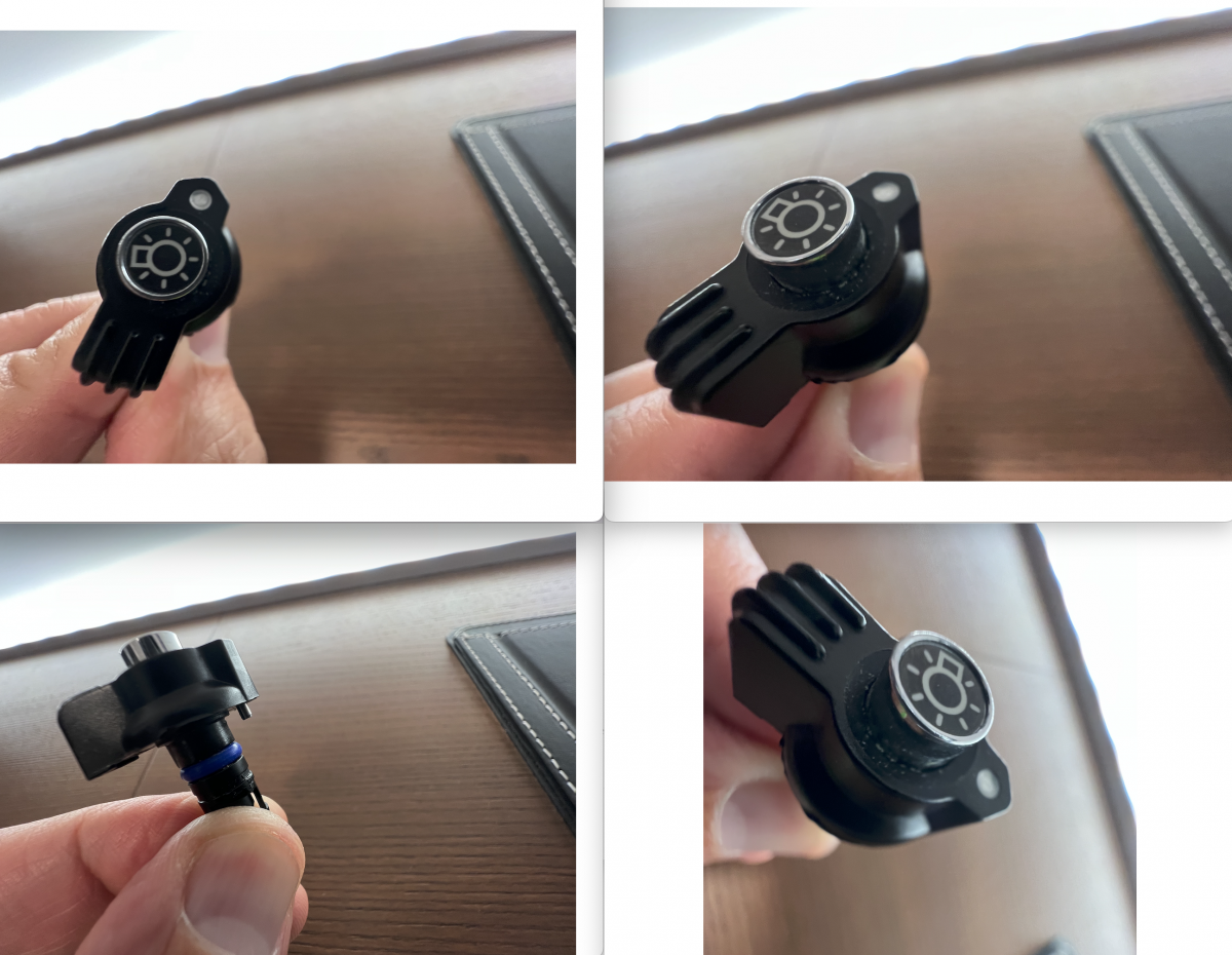

  10. Hello Tung,
    I have an identical knob taken apart from my recently dead YS-D1. I can send you the knob free of charge if you will. Regarding the replacement, please note that opening the strobe is no easy task since there are a lot of parts that need to be disassembled and later reassembled properly. Also can be very dangerous due to the high voltages and electrical charge accumulated on the two capacitors inside.
    Attached some pictures of the knob. Although the strobe models are different, the knob looks identical to me.
    Please let me know. I'm located in Europe (Italy).
    All the best,
    Roberto
