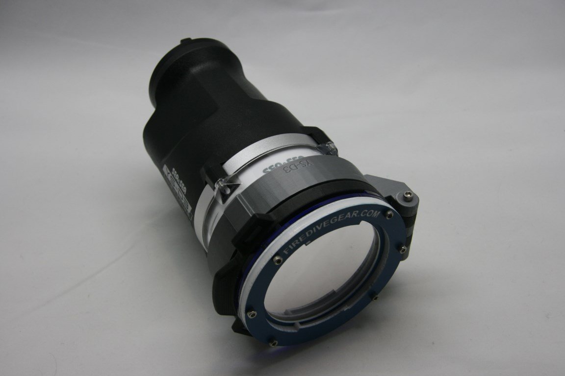

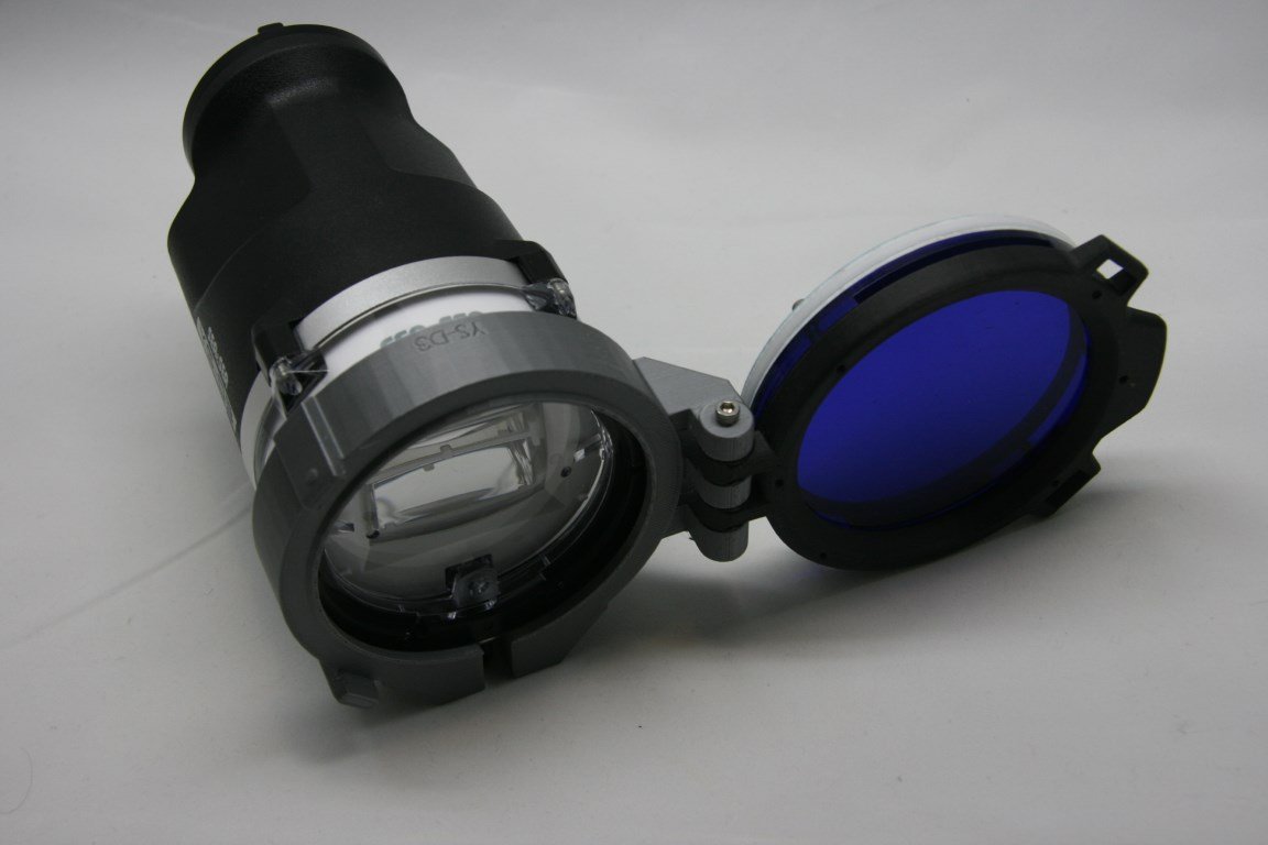

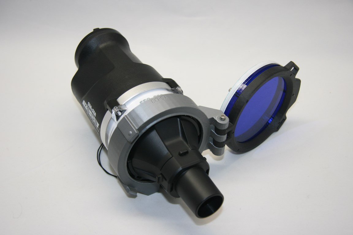

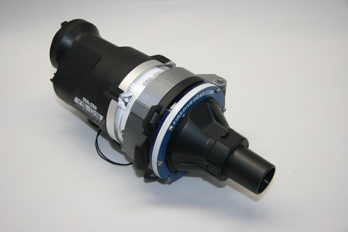

  2. This i what i use on both strobes (z240s Type 4):
    https://firedivegear.com/product/inon-flip-filter/
    They also have smaller version if the flip functionality is not required:
    https://firedivegear.com/product/inon-sandwich-excitation-filter/
    I can recommend these 100% - tested Dyron and H2O filters and these were utter crap (and also massively overpriced in case of H2O).  FireDiveGear are absolutely amazing. They also do custom ones if you use unusual strobes etc. They also make custom fitting yellow filter for your mask, so it fits perfectly.
    From my recent-ish conversation with them they also now offer filters than can accommodate snoot. So you have white or blue, or any of these with a snoot. Have not ordered these yet though as recently not having many chances to play with camera at all. Pics attached.
    Filters - using 67mm Big Blue (rebrand of Tiffen #12 i think) and 58mm B+W (022 Medium Yellow Filter). The former results in more greenish picture, the latter in more reddish.
    Setup wise i put both strobes on single 6inch arms, so instead of /\ camera /\, I have - camera -, with strobes upside down and set on max power (to avoid having to regulate power in pitch black) and just playing with f stop and shutter speed. As a spotting/focus light i am using Sola Nightsea (about the only Sola that still works....)

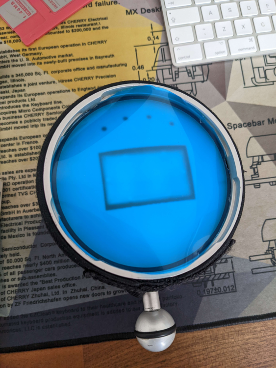

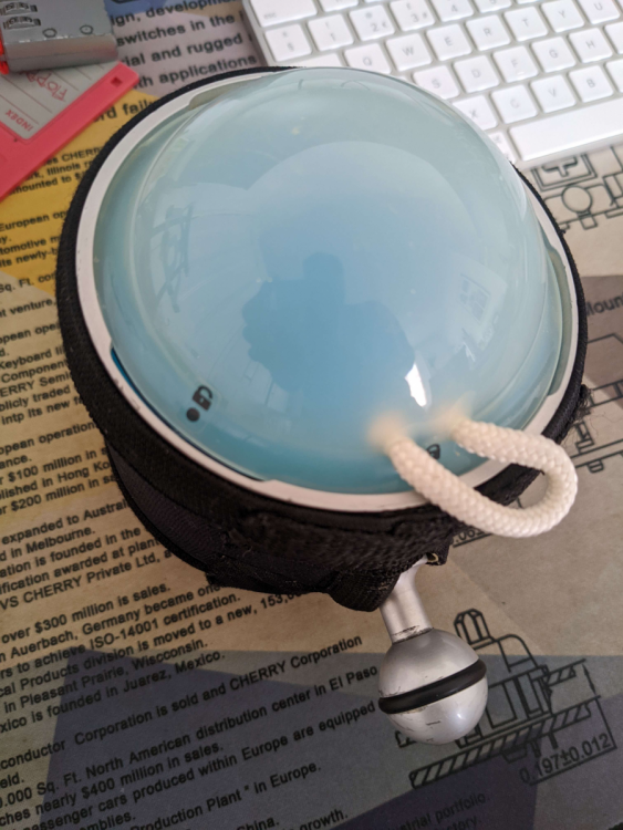

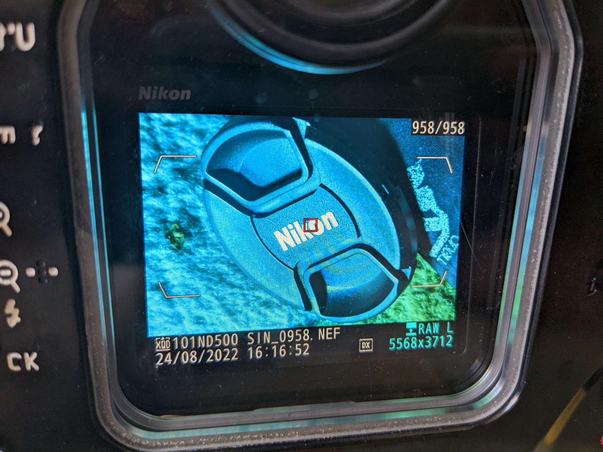

    However I've been using cut out gels now for my strobes and I'm getting some degree of success in general (sometimes they need layering as they don't add enough colour). I've attached a few examples of what I've got so far, but I wouldn't use this setup for fluro as the diffuser would get in the way of creating as much blue light as possible - but it shows that it's pretty easy to use gels/filters in strobes without a huge cost.
    image.thumb.png.c2c7074c72e7af5ae3b8eb2788f25336.pngimage.thumb.png.9a40de0d80fc20e653d1dddc41618586.pngimage.thumb.png.31e89548eeaecde23f8c87d333d2170a.png
    The most reasonable option I can see is from glowdive in Spain? Their Excitation filters are 48eur per piece, and use velcro. Ok it's not the most elegant solution but it'll do provided it stays put. --> https://www.glowdive.com/fluorescencia/filtros.htm
    I guess perhaps my question is: is there a way to DIY excitation filters?
    I'm sure I can come up with a pretty good velcro solution, but I am at a loss as to what exact material should be used, to create the excitation filters.
    Thank you for your time so far, it's been very useful!
