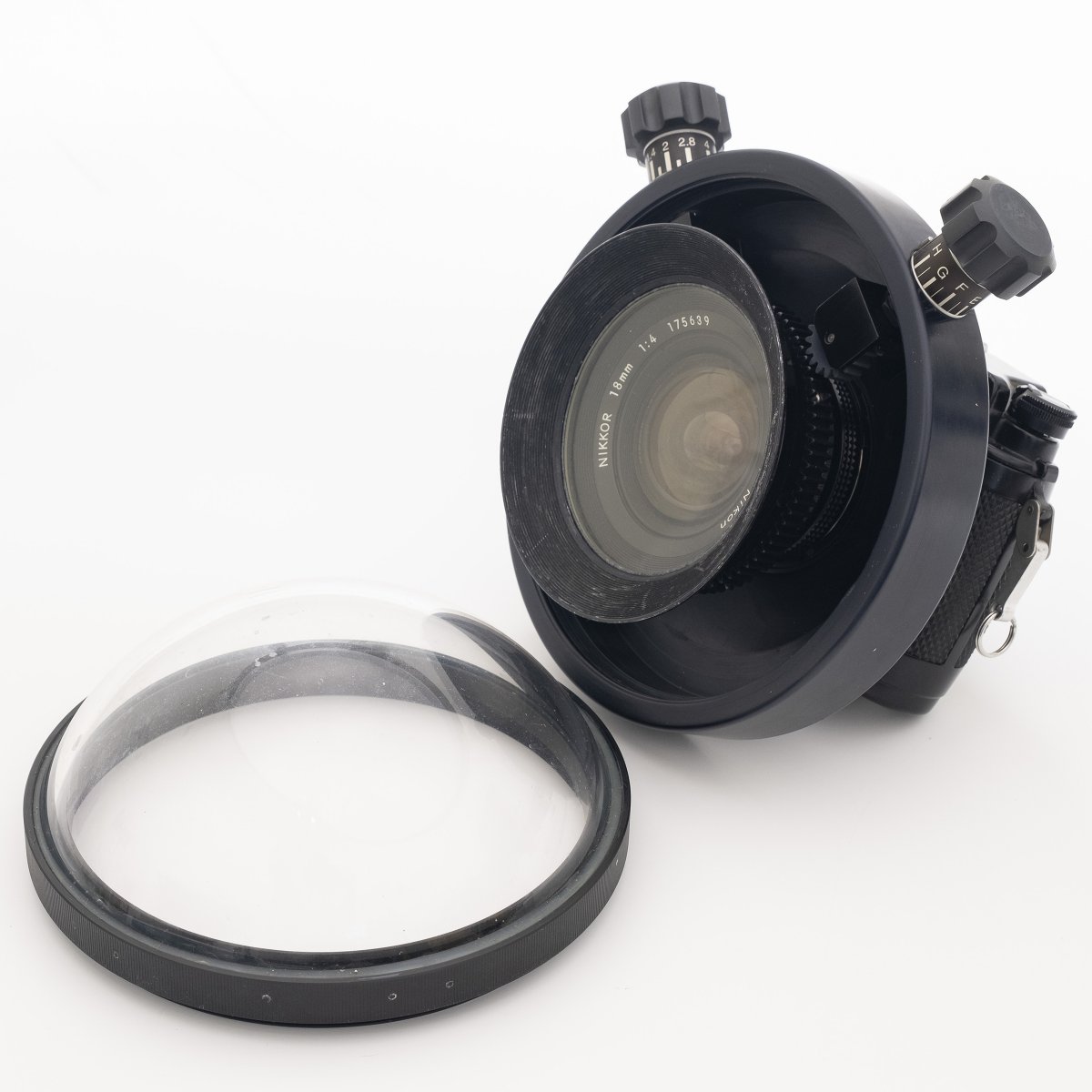

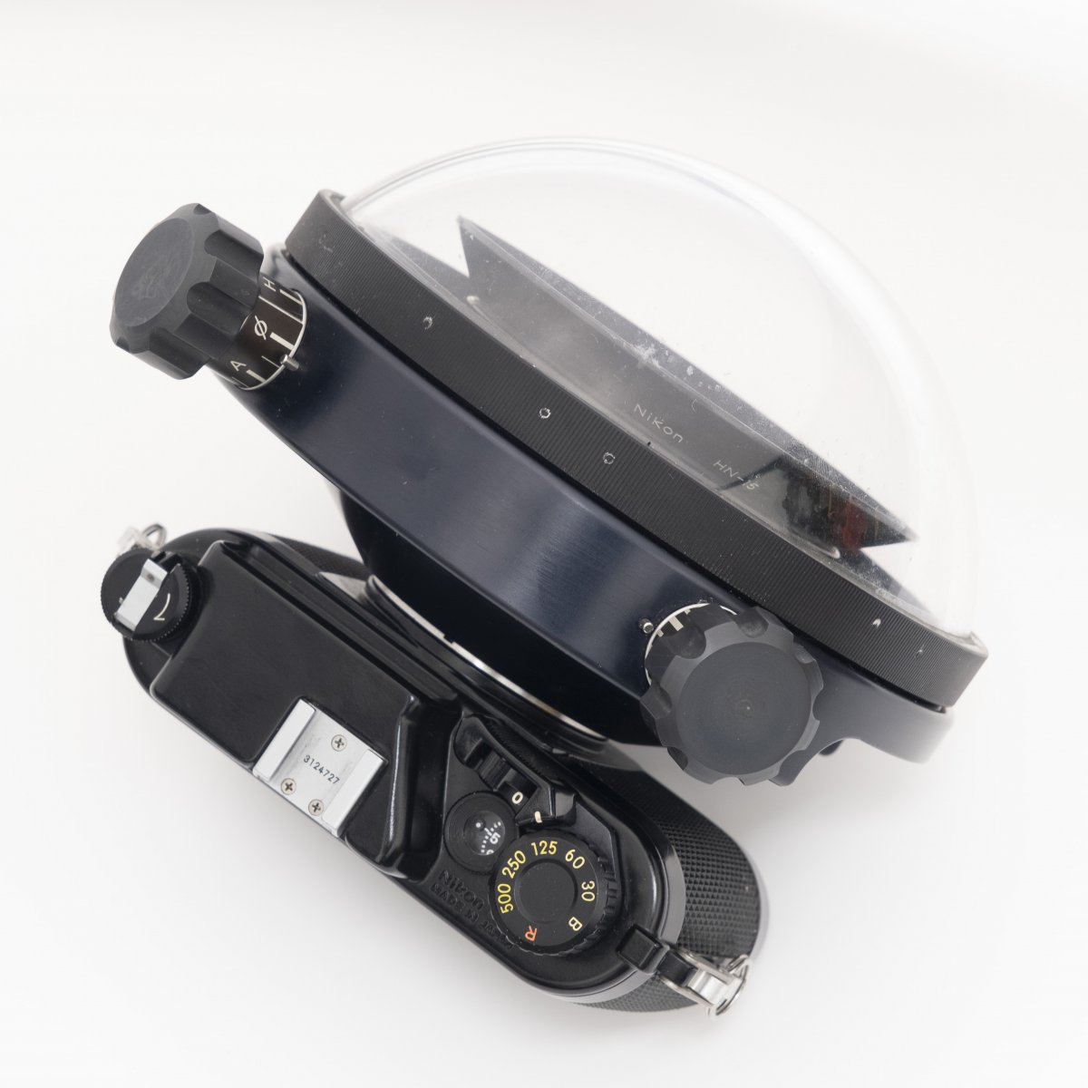

  5. Did you ever get the chance to use an Aqualens dome. It is a 6 inch dome port that you can mount lens with the F mount to a Nikonos.
    I have one I use with a n 18 mm Nikon lens. I will dig it out and post photo.

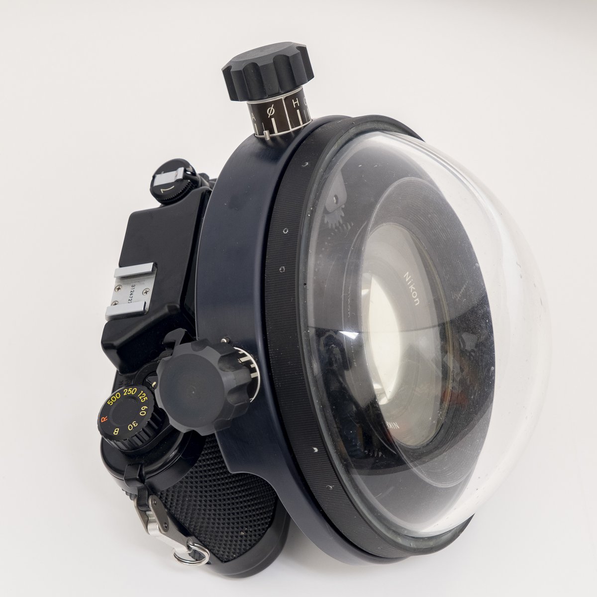

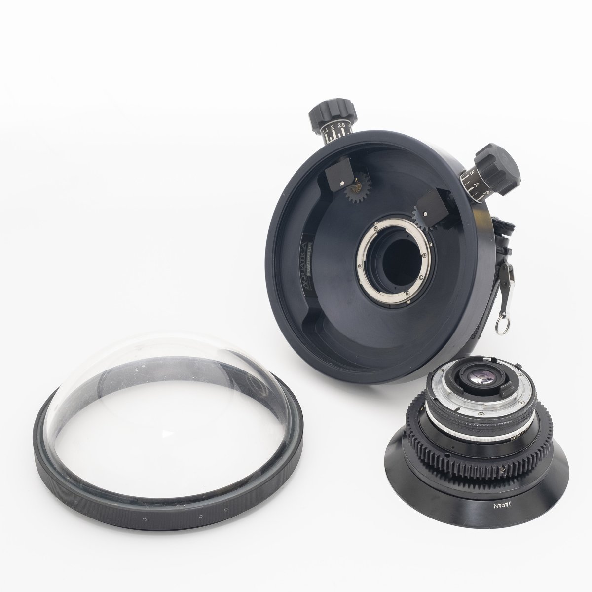

  8. Here are some picks of the Aqualens. I think it was produced by the predecessors of the Aquatica Housings. If anyone has more knowledge I would like to know. I used it with the 24, 20 and mostly the 18 mm nikkors.   Unfortunately the chromes I shot with this set up went underwater during Hurricane Katrina in New Orleans.
  9. Woah! That is a crazy setup. I guess I was imagining the lens with a dome built in. I didn't realize it was a dome on top of a Nikkor lens. What are the knobs on the top for? What an interesting setup. Did you like shooting with it?
  10. One knob for focus the other aperture. The 18 performed very well. It focused to 10 inches which was a little short of the virtual image of the dome. I will take it on my next local trip to Florida and shoot some film. It probably would work with the Sony/Nauticam set up for the Nikonos lens.
