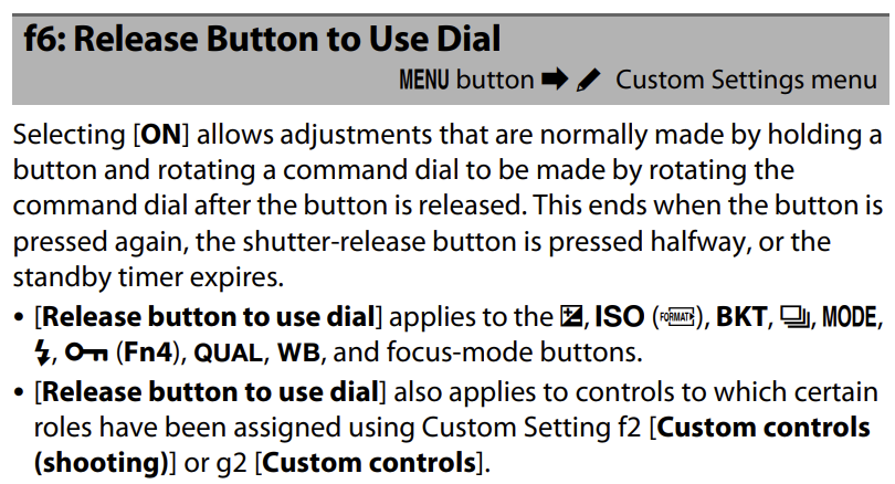

  4. Most Nikon cameras have a very neat function called "Release button to use dial".  For Z9 it is under f6, setting this to "On" then you only need to press the ISO button once, and adjustments to the ISO values can be made without holding it.  It ends with another press on ISO, or a press on the "menu" or half-press of "Shutter release".
    Cheers !
    P.S.  D850 should have the same function although I'm not sure whether its under f6.
    Edited by Edward Lai
  5. f6 on D850 too
