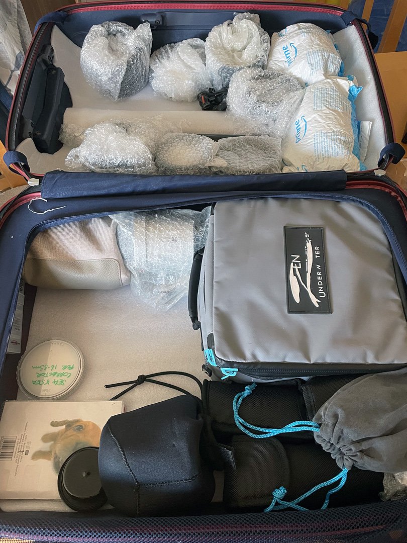

    My current technique is this.  Heading into the airport, I have the 1615 and a similar sized soft side gear bag, with all the dive stuff in it.  Both bags weigh around 40-45 lbs.  Using an "add a bag" strap or one of those straps that goes around the extended handles on the big bags, I have a small rolling bag on one bag, and my shoulder bag on the other bag.  When I get to the counter, I take those off and attach the shoulder bag to the extended handle of the small roller.  Once the bags are checked, I am left with the roller and shoulder bag combo that are about the same size as a normal rolling carry on.  That is what gets hauled around the airport.
    This site shows some more information about case  sizes:
    https://peliproducts.co.uk/info/case-comparison/
    Note:  I admit that I am more OCD in trying to protect the camera stuff than most people,  but I have had some bad experiences and seen some bad results from less protection, so I try to do what makes me less stressed.  Everyone needs to function within their own comfort zone.
    1615 with rolling bag
