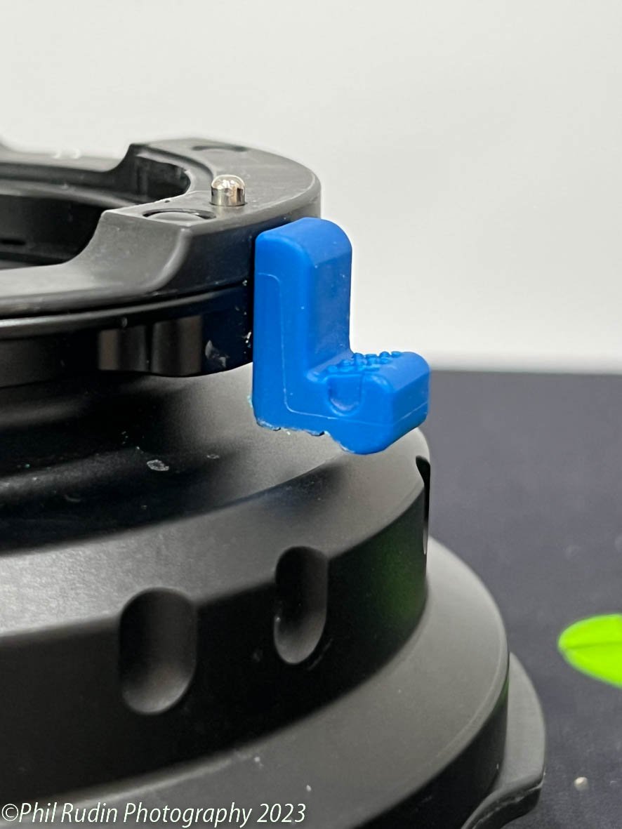

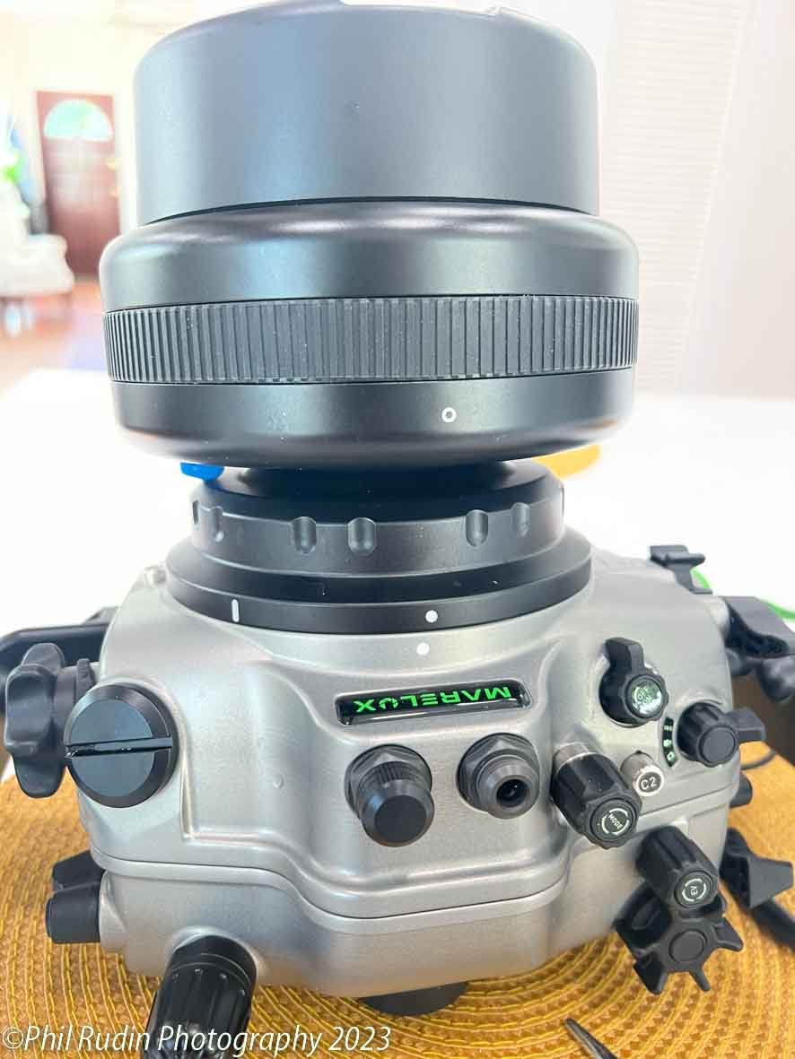

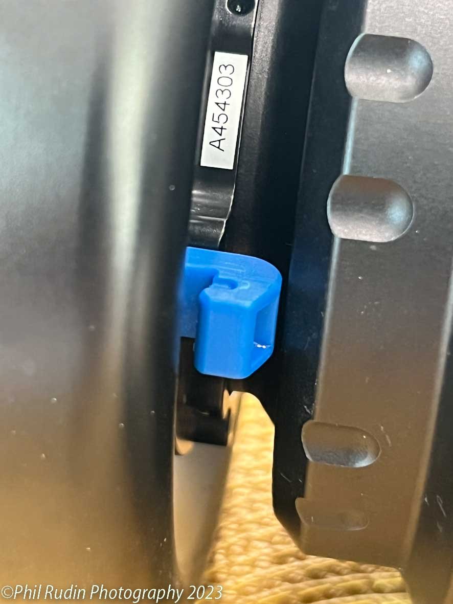

    Hi, i have a marelux A7IV housing and planning to get a wide angle lens for the 28-60mm. I was going to order the WWL-1B, does this mean it wouldn’t fit perfectly if i were not to shave off? I am planning to put the aoi quick release in there.
  17. I don't recall if the AOI lens mount for AOI wet lenses will work with WWL-1B. With the Nauticam bayonet lens mount on the shorter Marelux 32mm flat port the blue lens release does not fit well because the recommend Marelux port is shorter than the recommended 45mm Nauticam port for WWL-1B.

    Hi Zow, I have attached photos of the Marelux A7 IV housing with Nauticam WWL-1B bayonet mounted to the shorter than Nauticam MX-32mm port. As you can see the Blue nylon lens release hits the port unless shaved it down a bit (5/6mm). As you can see once you modify the release it works fine and leaves you plenty of room to depress the release.
