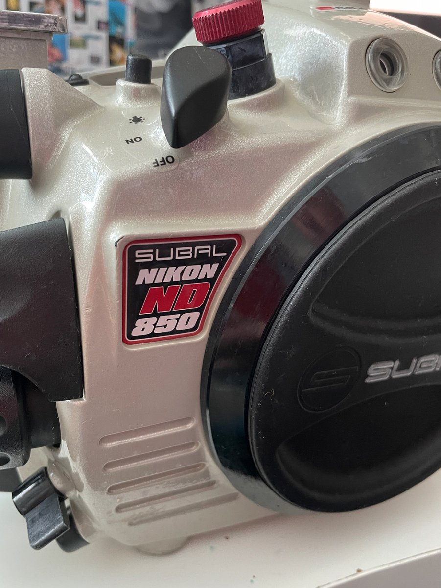

    My housing today. Main finish looks close to new.

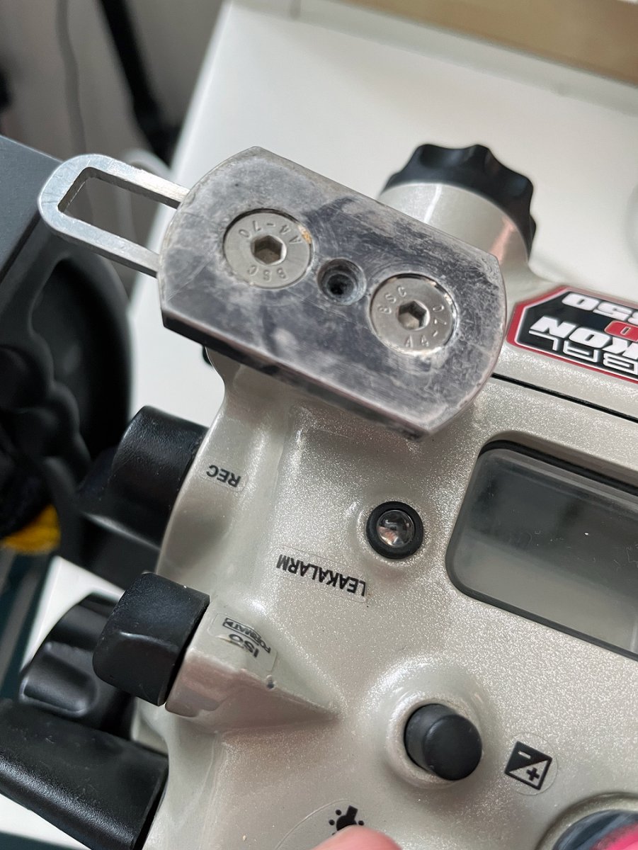

    But these Ultralight brackets, which are the same age as the housing, reveal the workload.
