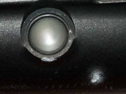

    Final question has to do with some wear on the housing anodisation itself. It seems that something rough has come into contact with the rear of the housing and (I think) exposed the aluminium in two small areas (the damage is half the size of a pea). Thankfully the housing was mostly used in a freshwater pool previously, but obviously I want to prevent any corrosion ASAP and would welcome any advice on this. I attach a photo of this damage.
