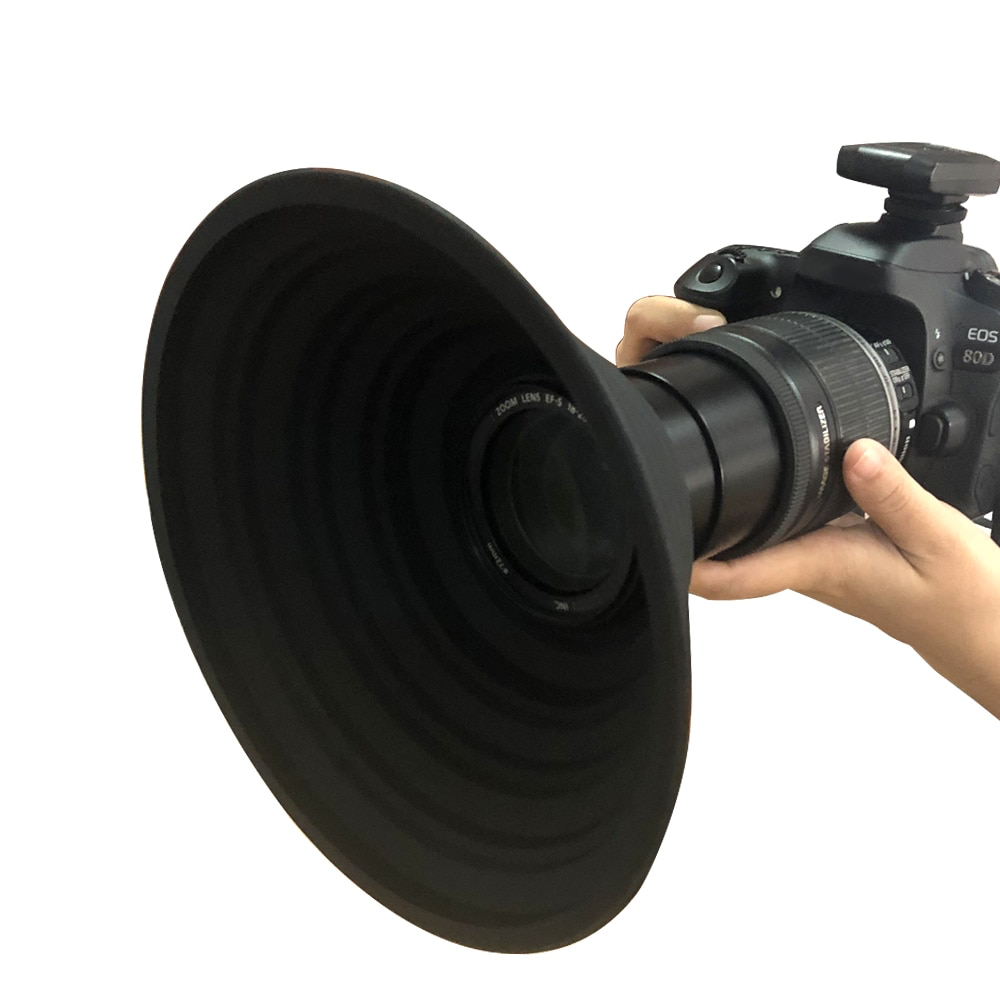

    I've come across two ways of sorting this out. One is to black out all the markings on the lens using a permanent marker or paint stick: all a bit drastic and it sounds like this might not do the trick for you.
    The other method is a matt black light baffle, made of material, that slides on to the lens - it looks rather like an umbrella with a hole in the middle for the lens. Amphibico used to make one but bandhphoto list this as no longer available.
    Here's a pic of, essentially, what they look like:
