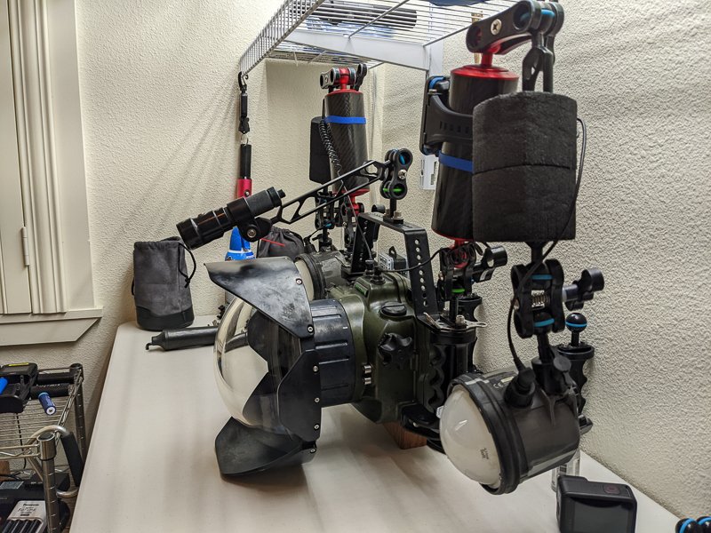

  1. I've been shooting a 230mm dome port (D810, D850 and Z9), and while I have finally got the whole rig very neutrally buoyant, it still wants to twist upward because the dome is so floaty.
    So the suggestion has been made to add some tire weights to the dome, and I'm just looking for details there.
    Specifically how much weight, and perhaps mounting locations (I assume bottom front). (Pics would help).
    Currently, with Z9/D850, dual YS-D1's and a focus light, six Stix floats have the rig extremely neutral.

    I did exactly what Tim suggested. I bought some black tire weights on Amazon and balanced the dome by adding weight, testing in a pool, adding more, … until the rig was perfectly balanced. I stuck the weights to the bottom of the dome shade so they would be inconspicuous. The weights also protect the bottom dome shade if it is set on concrete or another hard surface. I have not tried to remove them.

  10. I mounted my focus light on a 5" arm cantilevered straight forward so the front of the light is about even with the top of the dome hood.  Moving the focus light weight forward balances my 230mm dome quite well.

  12. See if it works for you.  Not only does it remove weight from the center of the kit, but it moves weight to the far front.  The further forward you can cantilever weight, the less weight you need to add in total.  And since you're already traveling with the focus light, you wouldn't be traveling with any additional weight (except the additional arm and clamp).

    Since I already changed strobe arms from a 5/8" combo to a 8/8", I have a pair of extra 5-inch arms I can use.   And since I replaced two strobe arm clamps with ones with rings (for clipping a handle to), I have a pair of extra clamps too.   So I will try this technique and supplement it, if needed, with the tire weights.

  15. I tried an 8" arm with YS mount on the light, and a ball mount on the housing today.  My focus light is fairly small, but it trimmed the 230mm dome very well.  A larger focus light might be cantilevered out too far with an 8" arm and would probably pair better with a 5" arm.
