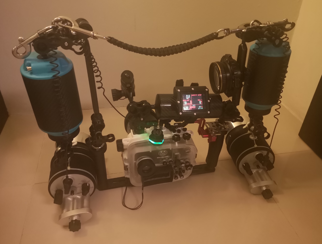

    Quick question - what would be an additional arm across the top be used for?
  4. I put a dive computer there, so that it's always in front of my eyes, although I mount it between the right tray handle and cold shoe.

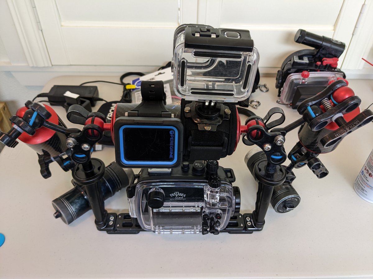

    Also, I've used both triple clamps, and Nauticam's Multi-purpose clamp + ball mount(72502) + (72511) to secure a cross arm similar to @Barmaglot, except both ends were secured.  The Nauticam clamps worked better for me, because you can leave the cross bar clamped down, and only loosen the clamp holding the arm.  With triple clamps, loosening the clamp to adjust the arm also leaves the cross bar loose.  Given the Nauticam price increases, I wouldn't go this route now, but in a 'money no object' world, that would be my recommendation.
  6. Photo of my wife's kit showing multi-purpose clamps on cross-bar.
