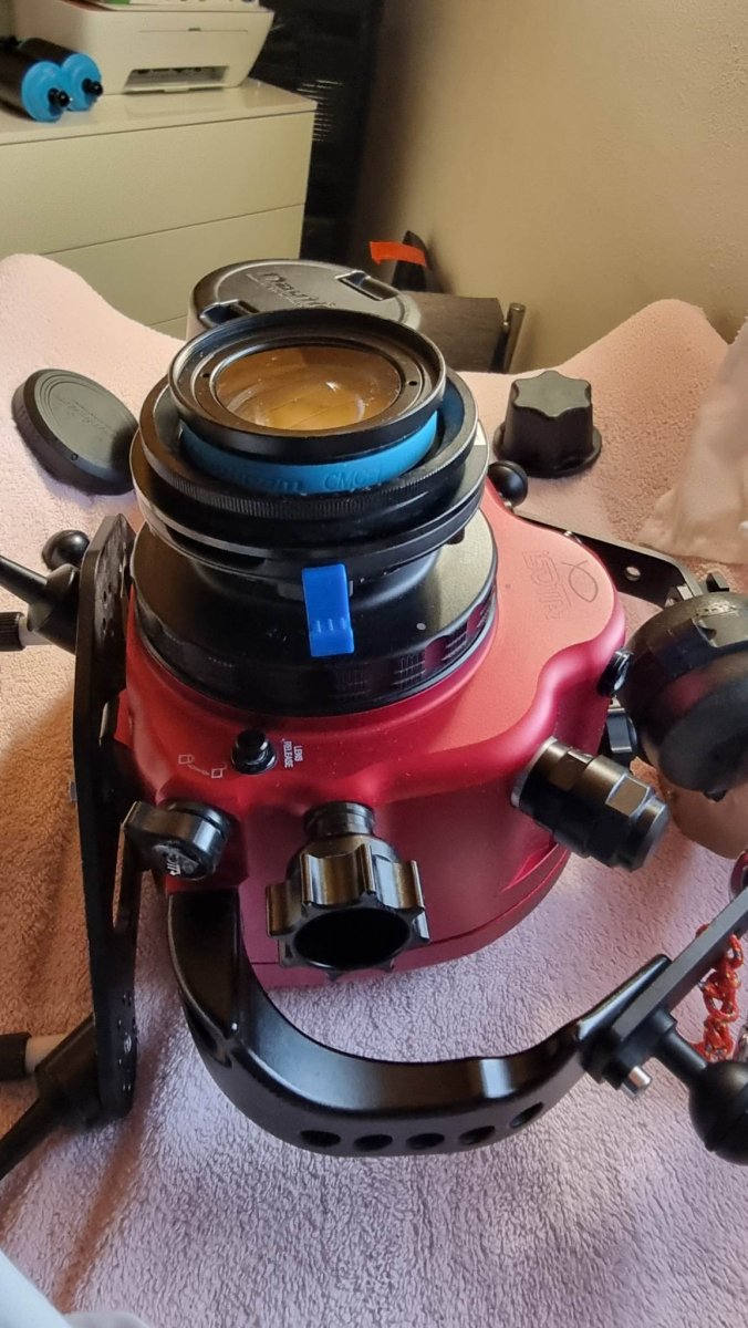

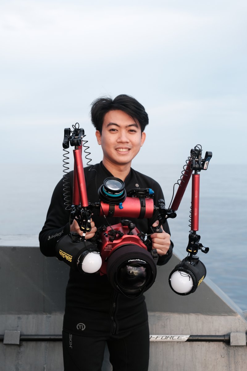

    Camera : Isotta SONY A7RIV + 28-60 mm
    Zoom gear for 28-60 (is-3540)
    M67 Macro port H63 B120 (is-2364)
    Nauticam WWL-1B + SMC-1
    Strobes : Sea & sea YS-D3
    Thanks Elisa Isotta for customizing my zoom gear. I really recommend Isotta Housings. Very good customer service. Italian-made aluminum housings are compact, meticulously engineered, and ergonomic.
    Thanks Thomas from Backscatter Underwater Video & Photo for your advice about my housing : Isotta's housing plus Nauticam wet wide lens.
    I have tested it underwater and the result is great. No vignetting at wide open 28mm. Corner sharpness is quite good ( Better than 16-35 with glass dome port but not equal WACP).
    In addition, in the single dive I can shoot both macro and wide angle. It’s a great solution.

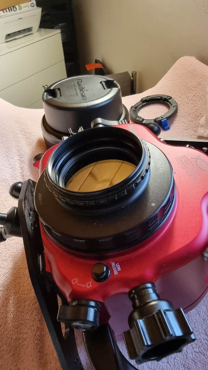

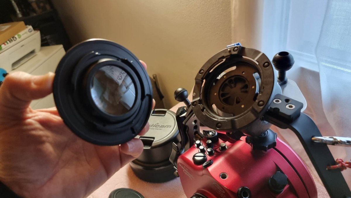

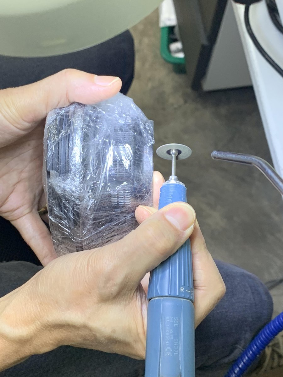

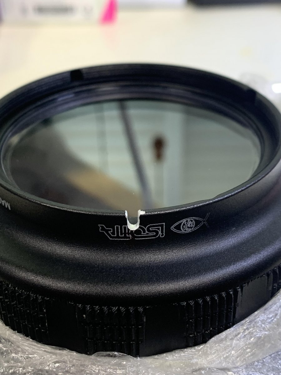

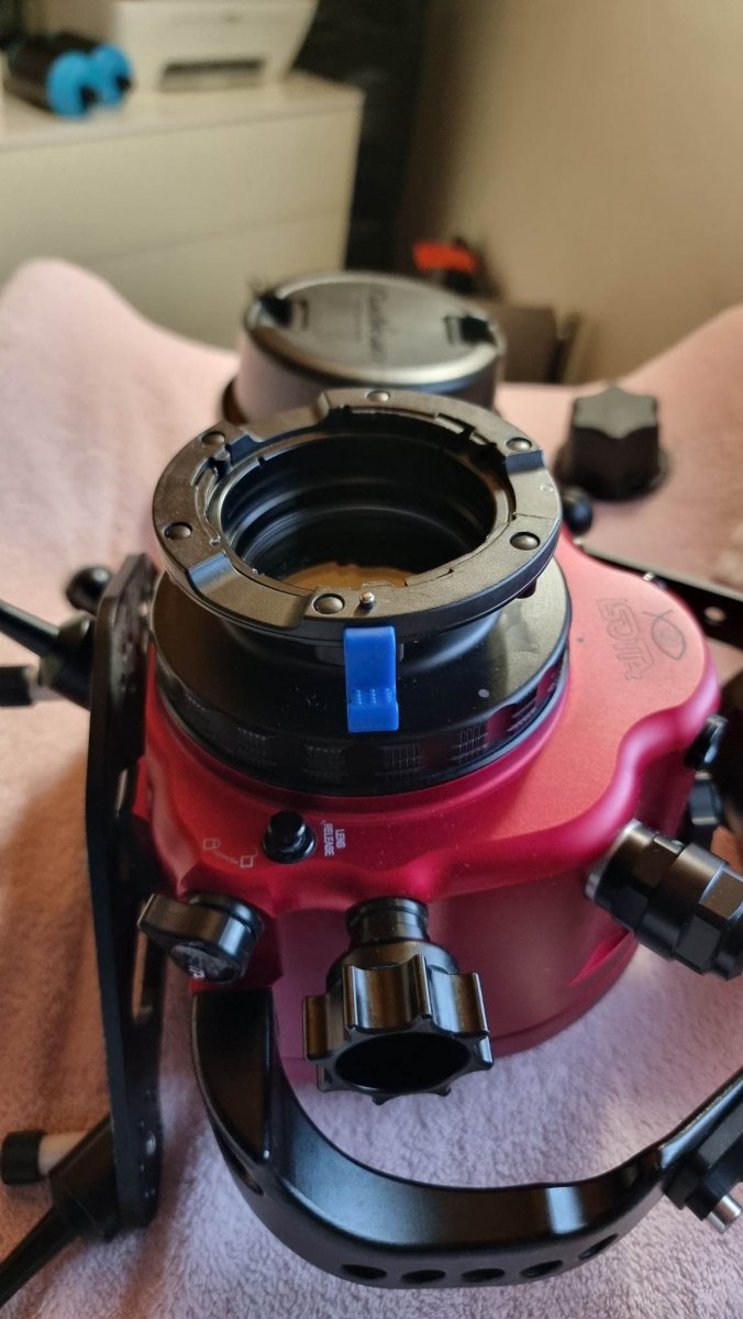

  6. So did you just get the port customized so it has two notches like all the nauticam ports have?
    No. I do it myself because I'm not sure how to tell Isotta where exactly to make the notch ( If the notch moves off center a little bit, the dome shade will show in the picture.)

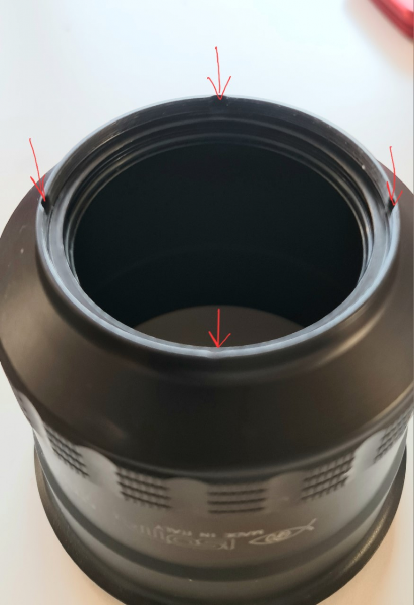

    That's awesome but i don t understand why you had to grind additional groves, the issota port already has four groves image.thumb.png.73f004fcecef7bbbf9f57ee997cb60c9.png
    The Nauticam bayonet mount adapter has a pair of locking pins which span the groove that goes over the port flange:
    Nauticam's own ports have a pair of matching cutouts:
    ...so if you want to use those pins to prevent the adapter from rotating, you need to replicate at least one of them.

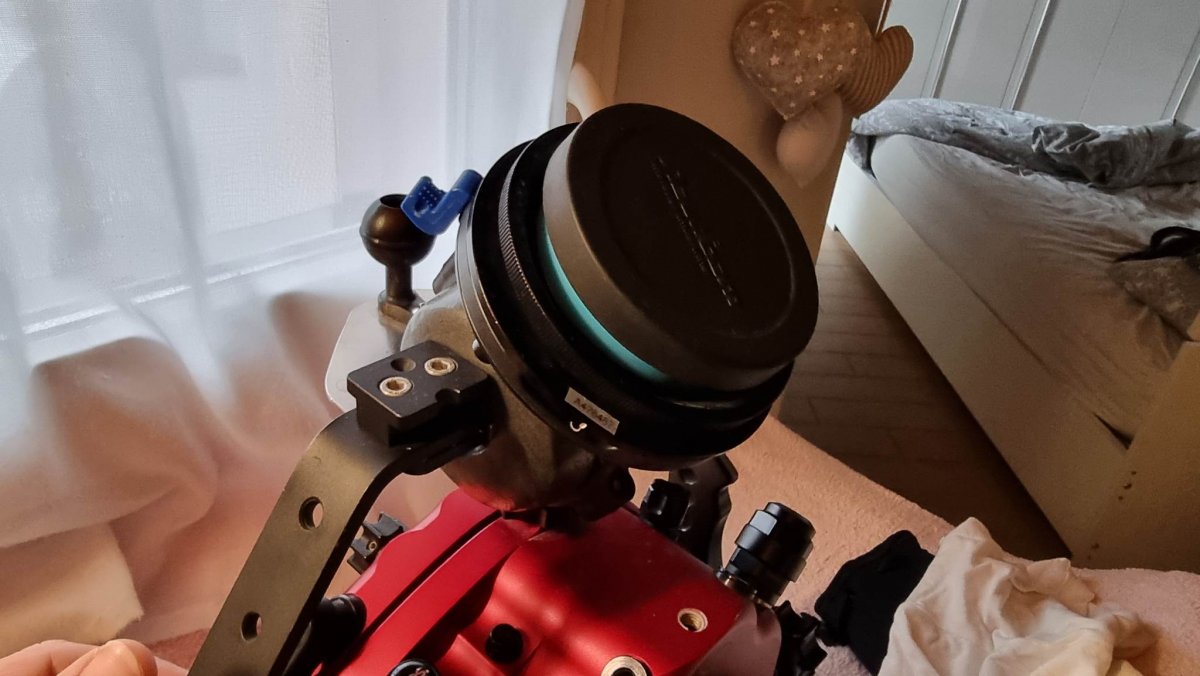

    Thank you for that makes complete sense!  another and last question anyone got any idea how Enrico managed to attach his wet lens  on the isotta handle bar?
    I'm not Enrico, but I would guess a plastic hose clamp + Nauticam bayonet mount lens holder, probably the model for Inon float arms, with the screw attaching it to the hose clamp instead of the arm itself (Inon arms have a threaded mounting point for lens holders, but the tube in question looks like a 70mm Isotta arm, which does not have that).
  16. yes i have both also i know that the thread in the inon arm is not m8 which raised the question after a bit of research he used the 70mm nauticam bracket  many thanks barmaglot
    Edited by nomadadv

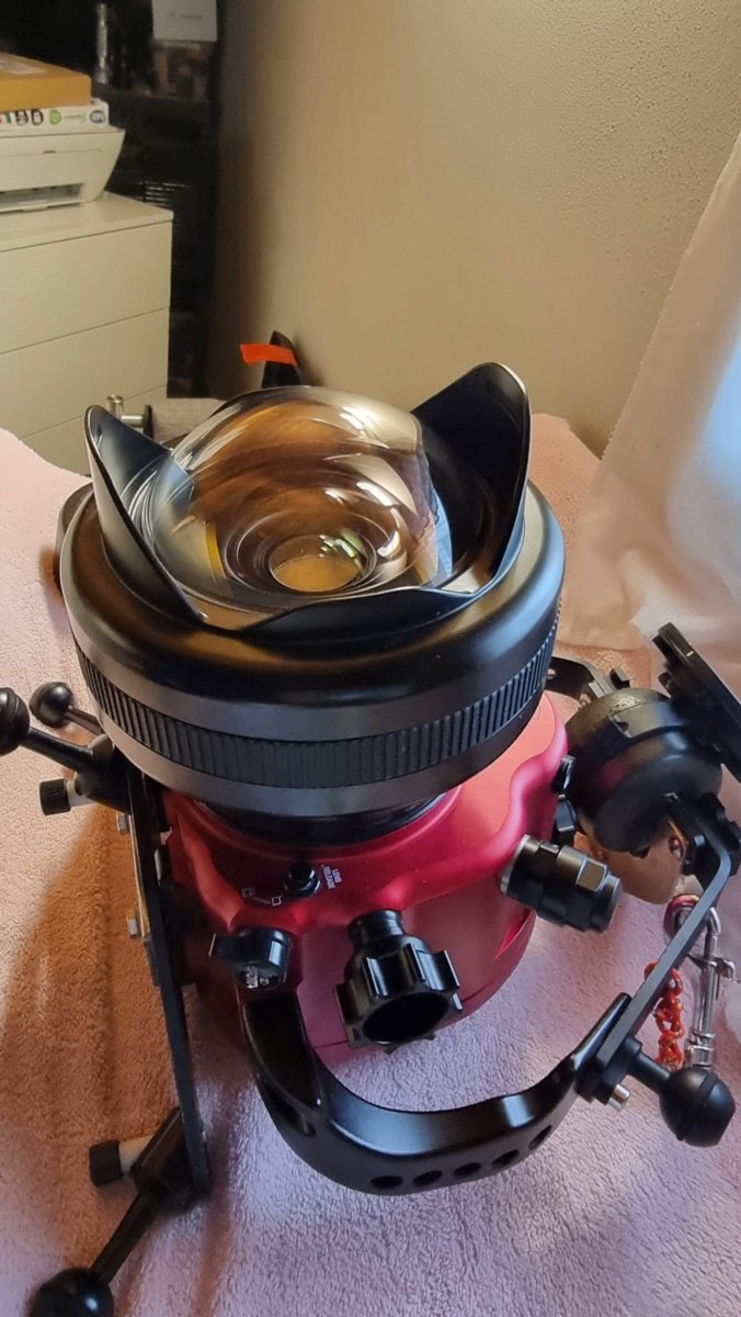

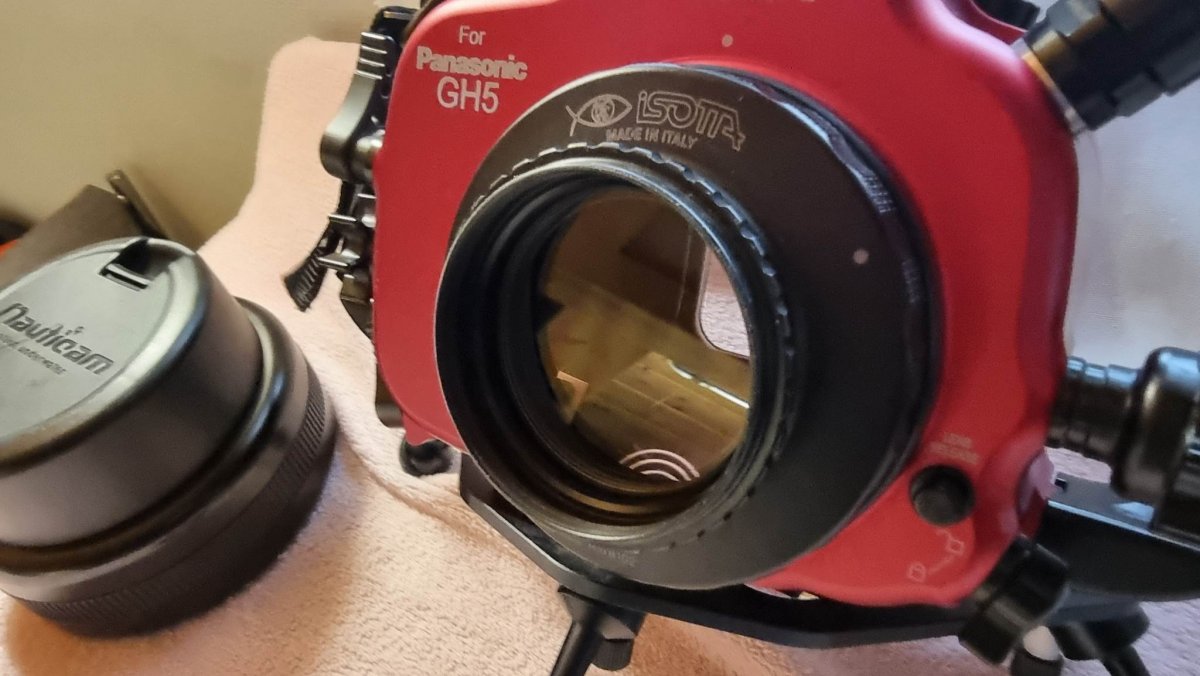

  19. Enrico Rabboni sent me some photos and explanation of his mod setup that couldd be useful to other isotta users.
    He subscribed to WP but he forgot to post them so I'll post for him.
    Basically FWIU he got a custom M67 flat port and a zoom gear for Pana 14-42mm form Elisa Isotta. Other bits are all standard nauticam parts. He can swap CMC-2 and WWL-1 underwater and he has full zoom.
    He managed to mount the baionet adapter without having the cutouts.
