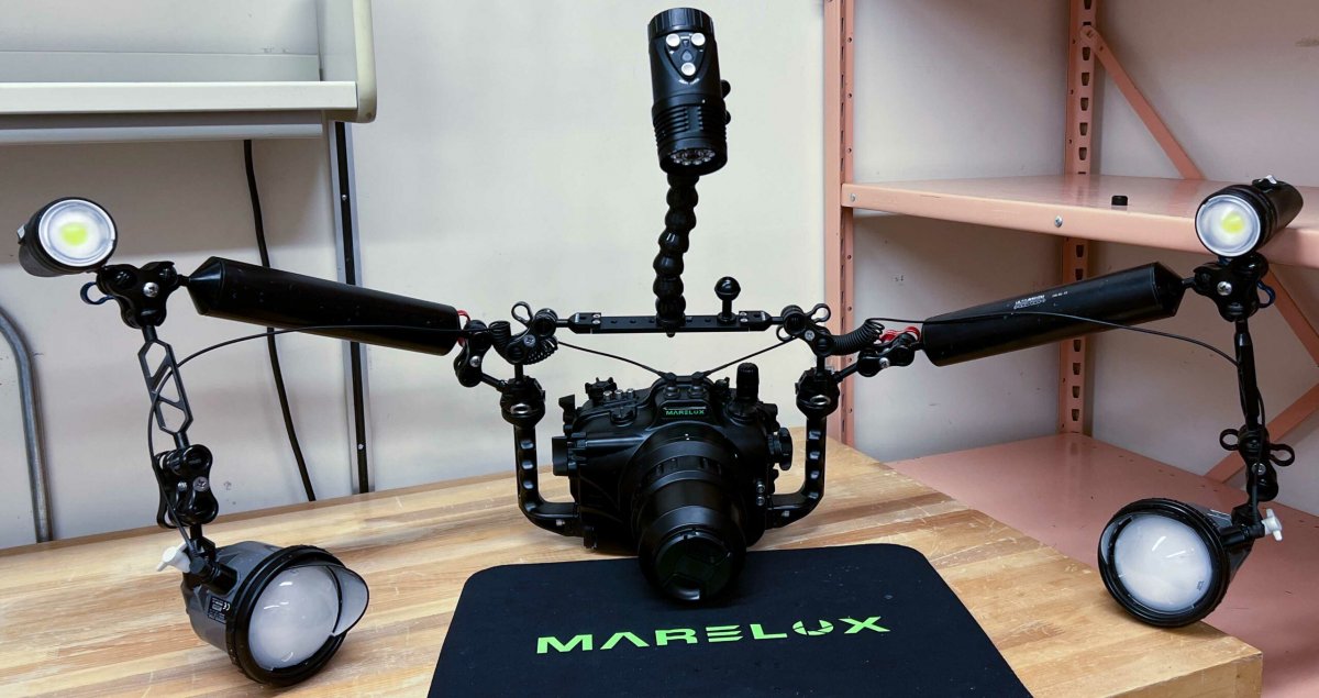

  3. Do you mean aiming light or video light?  I run my video lights on arms out to the side just like my strobes to avoid backscatter and also make the lighting more dynamic. When shooting macro or needing an aiming light, I run a ultralight bar (the one with the screw holes) between dual ball mounts on my housing arms.  From the center of this I either run locline or balls mounts and add aiming lights or a macro light depending on the use plan (and sometimes a go pro). Here is an image of it setup (it was really, really dark, so I used the Solas as my dive lights and the two strobes and macro for image collection).
    I like this setup! I just discovered the crossbar so I'll look into that. Thank you!
