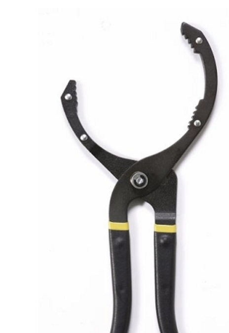

  10. After much praying, crying, and bagging, this tool did the work:
  11. Looks scary. Great that it worked though. I can well understand the progression from praying to crying - sweating too .....
