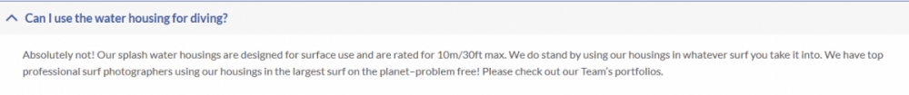

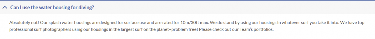

    It would be a split only dome as well - do diving combined with surface work for splits - from their FAQ page:

  4. That's rather obvious; if the OP hadn't specified split shots as the sole application I wouldn't have suggested it.

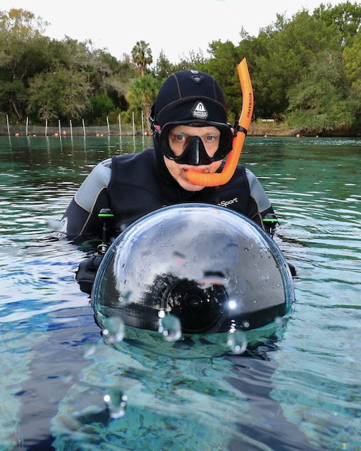

    I suggest you checkout the Manny Smith, mannysmithphoto.com line of ports specifically designed for splits. I have paired the 12 inch dome with my WACP-C for travel. It is light for its size, comes with Nauticam mount among many other mounts, is rated to two meters so also great for images near the surface in addition to splits and is cost effective for its size.
    You can read my review of the 12 inch Matty Smith dome port in the current issue of UWPMAG.com a free PDF download.
    Photo by @Courtland W. Richards.
