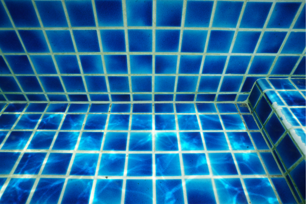

    16-50mm @ 16mm through flat port; note the pincushion distortion:

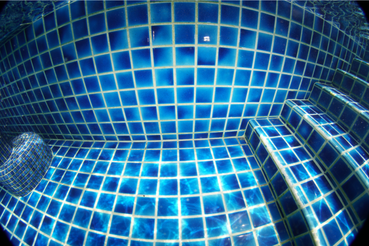

    16-50mm @ 16mm through 6-inch dome:

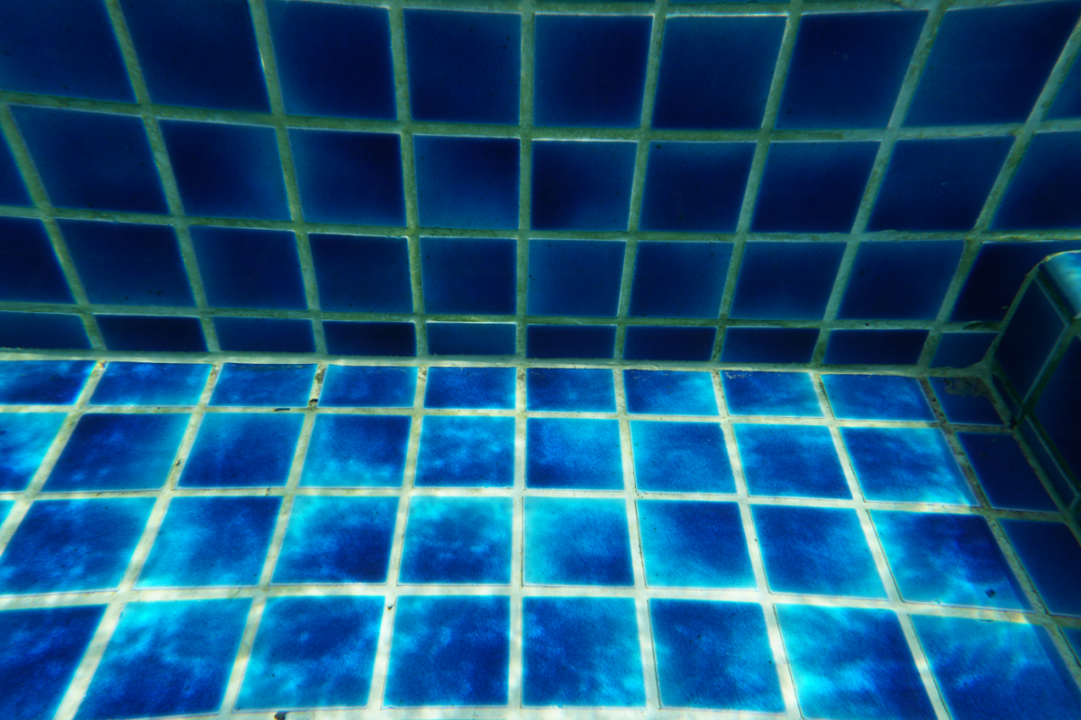

    10-18mm @ 10mm through 6-inch dome:

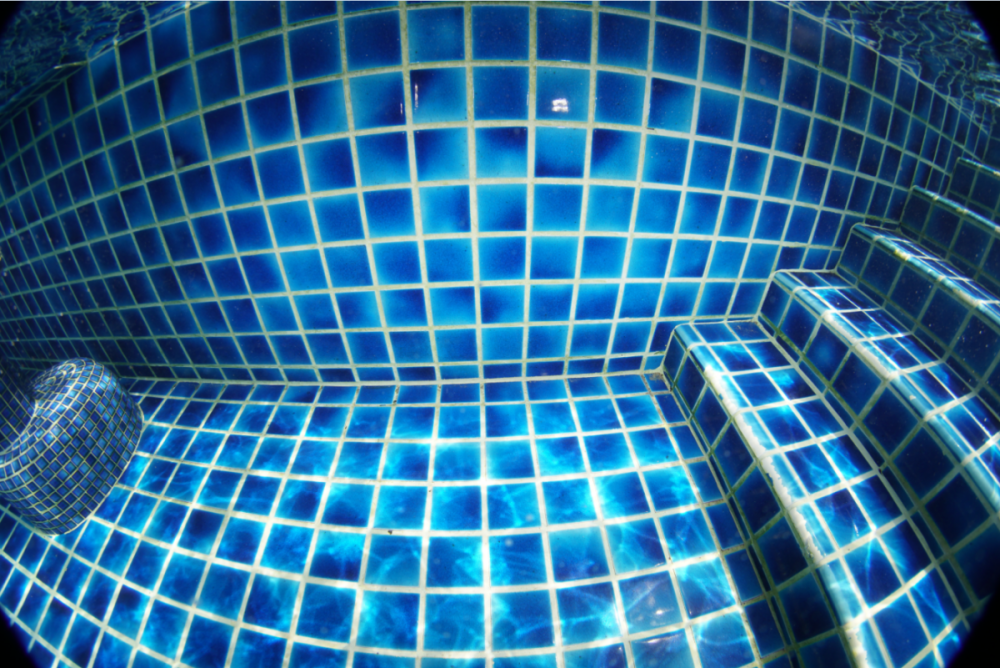

    7.5mm fisheye through 4-inch dome; note the corner vignetting:

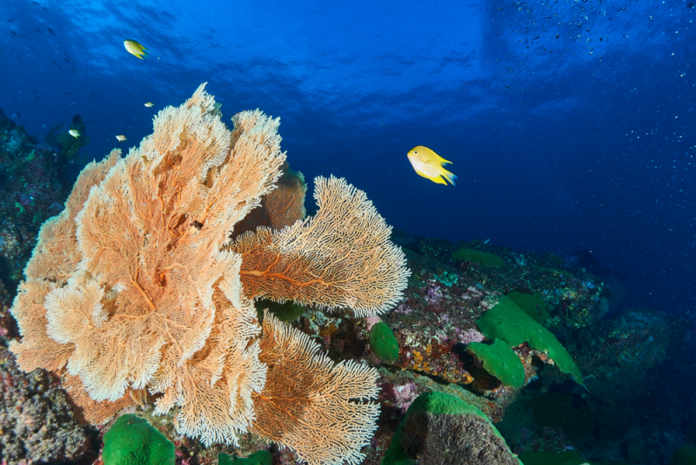

    Sample reef shot with 10-18mm and dome:

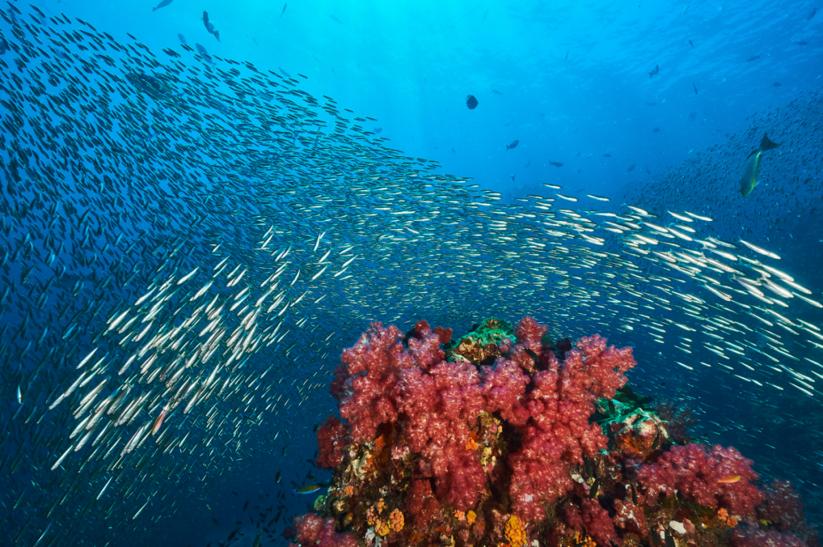

    Sample reef shot with 16-50mm ant UWL-09F:
