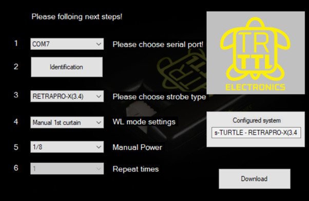

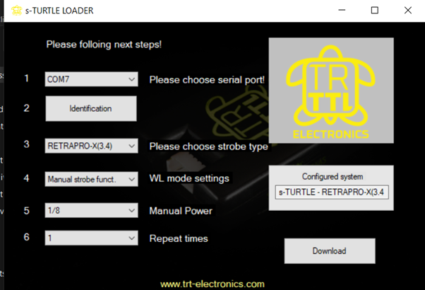

    Turtle trigger settings. I have done some trial and error and tested the two setups below with the above-mentioned camera settings but neither works. I made sure each time Wireless flash (WL) was ON, but shuter spee is blocked at 1/250.

    The settings you have there are correct
    You need to go into the camera set wireless flash to On
    At which point the camera will let you exceed the shutter speed and show Wireless HSS on the left of the screen

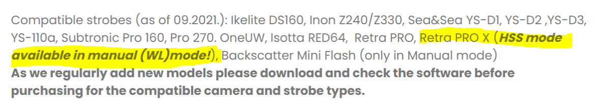

  11. Just go on the Website of TRT.
    Simple screenshot from the Sony e-TRT (Yellow highlight is from myself...)
    This works perfectly well for me (with Sony A1, mech and electronic shutter  and Sony A7RIV , mech shutter only), Retra Pro-X and TRT s-TURTLE  SMART
