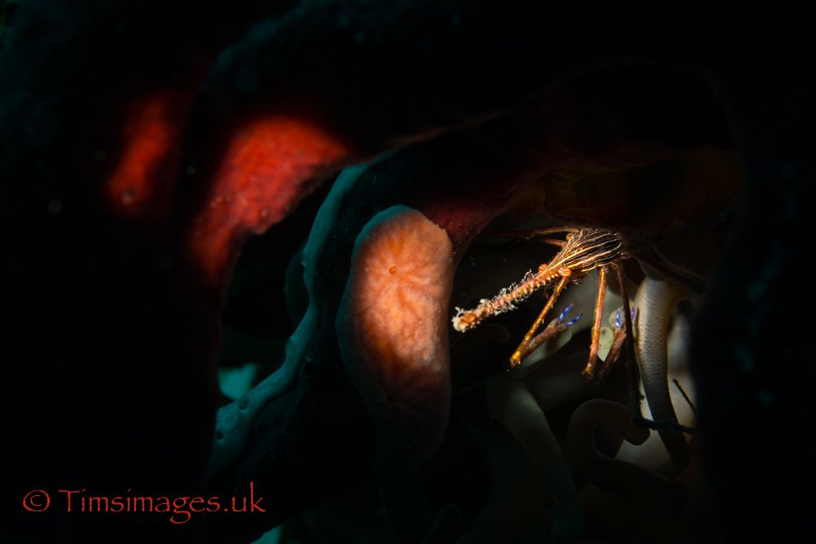

  3. Hi Larry
    An interesting question.
    A bit like you, going back to 2009 when I was diving daily, I found a combination using the Nikon D300, Inon Z240 strobes and the curious Heinrich Weikamp TTL convertor that gave me terrific exposures - 99% of the time for macro and only slightly less for wide-angle. As you rightly say, perfect for those quick shots when something comes along unexpectedly - and nailing that tricky macro critter.
    A change to a D800, only holiday trips and mainly wide-angle (Red Sea) had me shooting in a slightly different way and perhaps didn't use TTL via the D800 built-in flash quite so much.
    I'm now on a D500, 75% macro and usually with a snoot. For that TTL would not work as the images sure do not meet the TTL aim to achieve a balanced exposure approximating the old 21% grey card standard.
    As you have heard from others, moving to Manual is much easier than perhaps you might think if you are used to TTL. Whereas you will (in theory and often in practice!) get a balanced exposure, with Manual you can choose not to do that and go beyond what you either get from TTL or TTL adjusted with exposure compensation. I attach a macro pic as an example.
    So perhaps not using TTL gives you an element more of creativity and encourages the photographer to try that path?
    As Chris suggests too, recent experiences have shown me that TTL does indeed work better on some systems than others - indeed consistency even between like cameras with like strobes is not automatically a given.
    Again as Chris says, if you're happy with what you are getting, great. Isn't that the most important aspect: enjoying what you are doing and happy with what you get? But if you fancy being a bit more adventurous, I'd suggest it is worth turning off the TTL and seeing what you can achieve to break the rules of a nicely exposed image......
    Beautiful shot! This is a great point Tim, I am just getting started with using a snoot and TTL obviously won't work for that.
    I think you and Chris are right and I should start using manual settings to be more creative in my shots, especially macro. While TTL works great for me and the exposure is perfect, it does produce a flat image.
