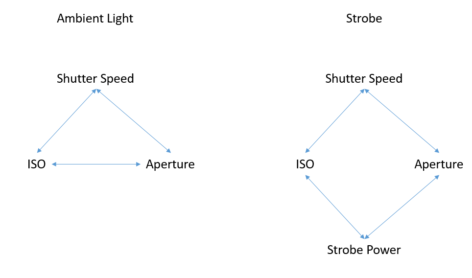

  5. There are two schools of thought, (1) most people are using the exposure triangle for ambient light photography and (2) using the exposure diamond for flash/strobe photography.  There are a lot of people who are afraid to raise their ISO for fear of image degradation.  I have used ISO as high as 8,000 on my Olympus EM1-3 without fear, this past new years eve my kid was playing with his cousins and the dogs in the backyard and I needed to use a high iso to freeze the motion and guess what I was able to get some pretty good images for family use.  I use On1 Photo Raw to edit my images and it has a noise reduction plug in that works really well.
