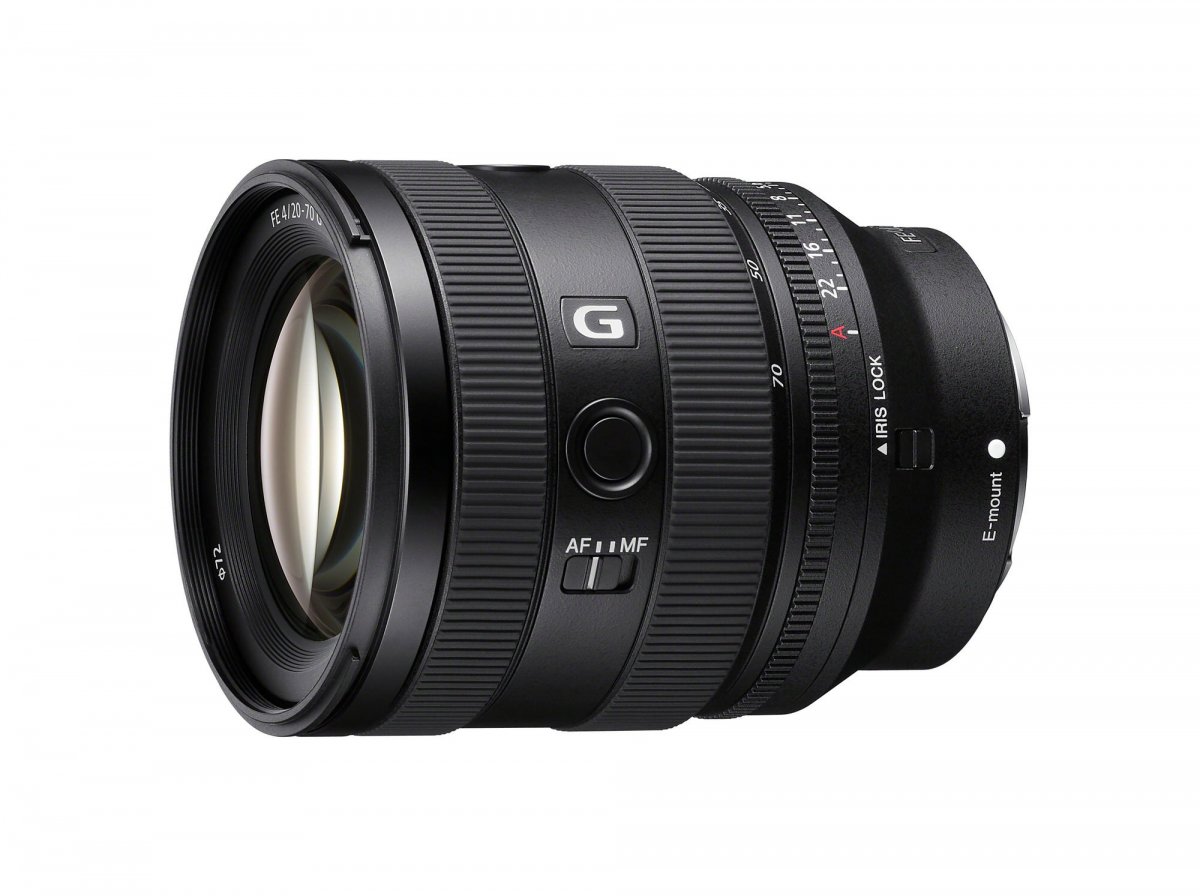

    You may also want to consider the new Sony FE 20-70 F/4 announced yesterday. This new lens is a constant F/4 across the zoom range and also focuses at 25cm across the full range, so about 1:2.5 at the 70mm end. I suspect this lens will be ideal for video and stills use. It has all the latest Sony lens tech including the ultra fast focus motors.
    Maybe just behind a dome.
    Zooming it extends a lot!
