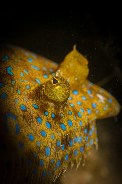

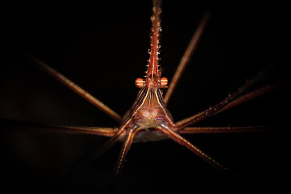

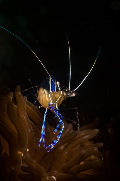

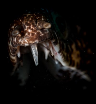

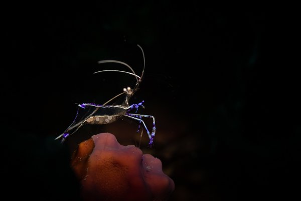

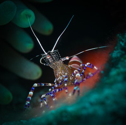

    Here's a couple of pics take with the D500/105 just to give you an idea.
