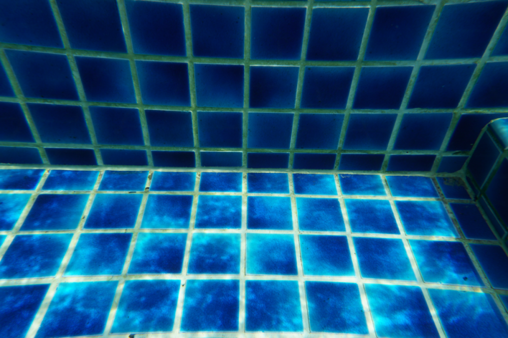

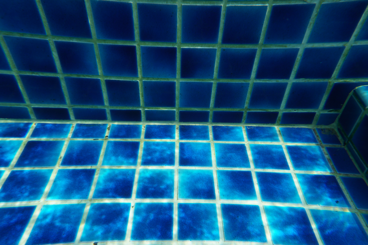

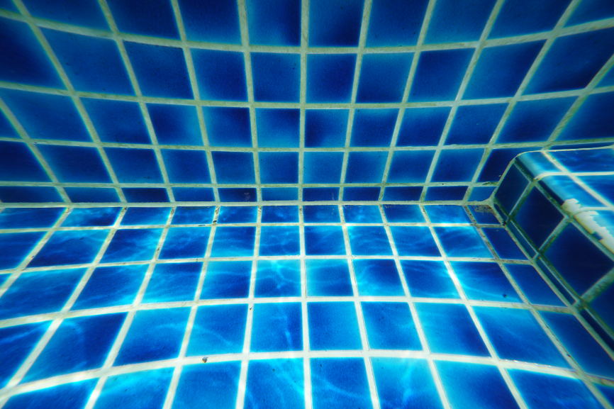

    A wide-angle lens behind a flat port will suffer from severe pincushion distortion. Example 16mm APS-C (24mm FF-equivalent) behind a flat port in a pool:

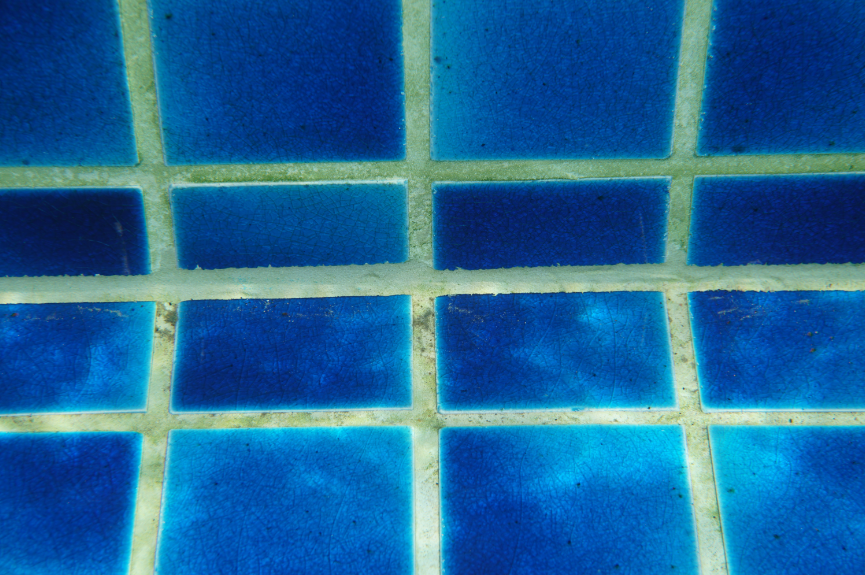

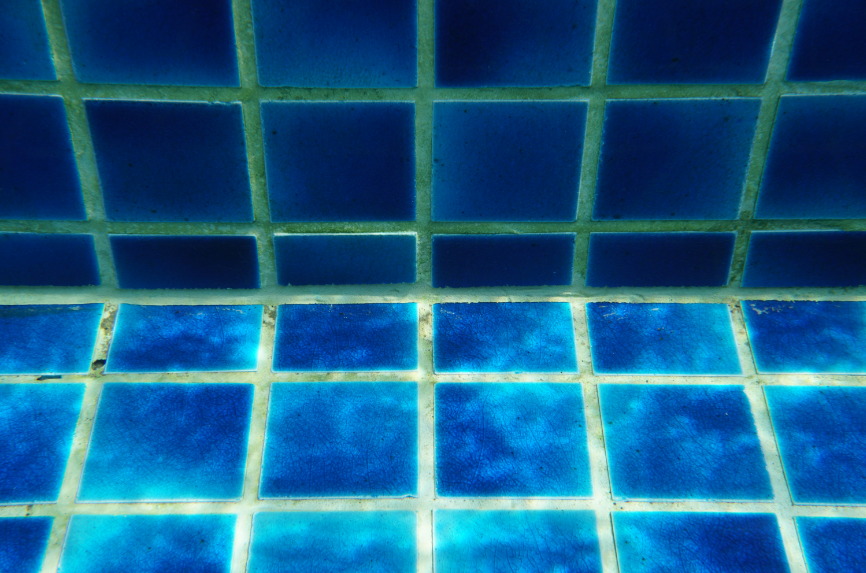

  5. Thanks for the example, yes I understand. What about longer focal lengths like 35mm/50mm/85mm FF-equivalent? Macro lenses are mostly used behind flat ports. At what focal length would a flat port give better image quality than a dome? It might also depend on the focus distance? I'm not planning to do macro shots, but like to use longer focal lengths for a human face or half-body shot for example.

  6. 10mm (15mm-equivalent):
    30mm (45mm-equivalent):
    50mm (75mm-equivalent):

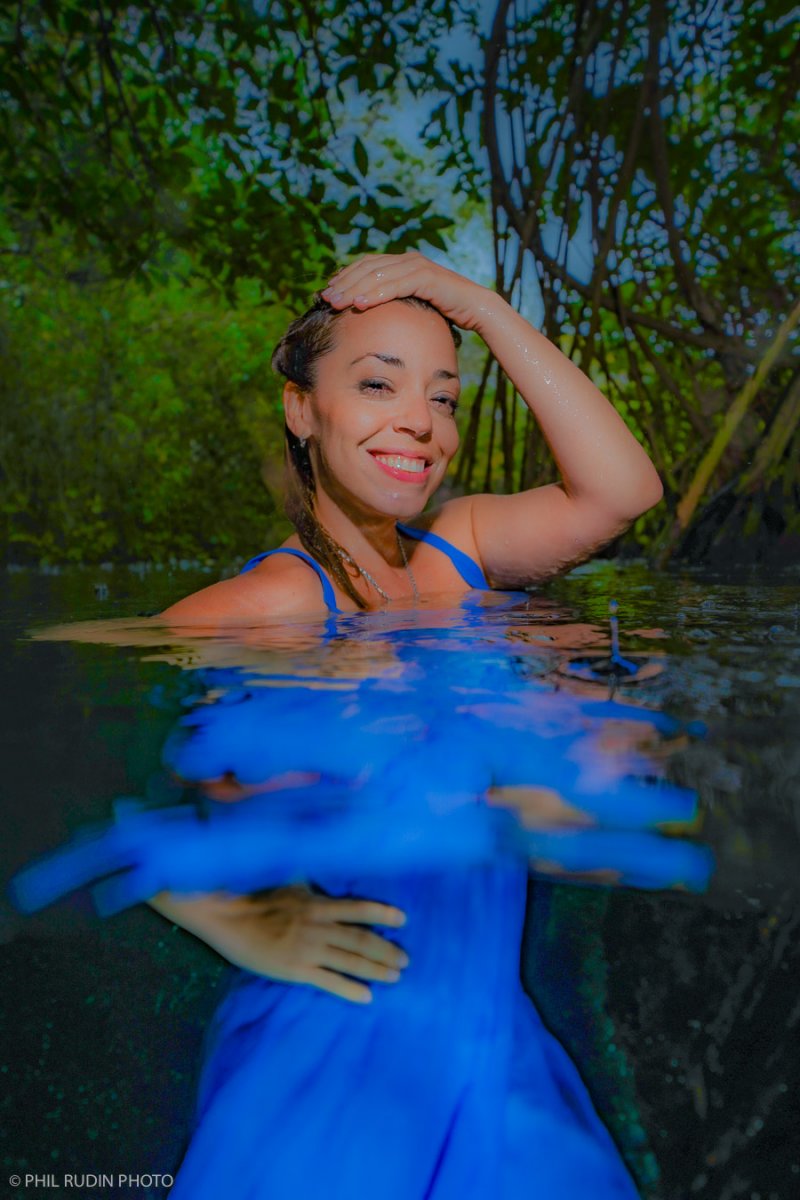

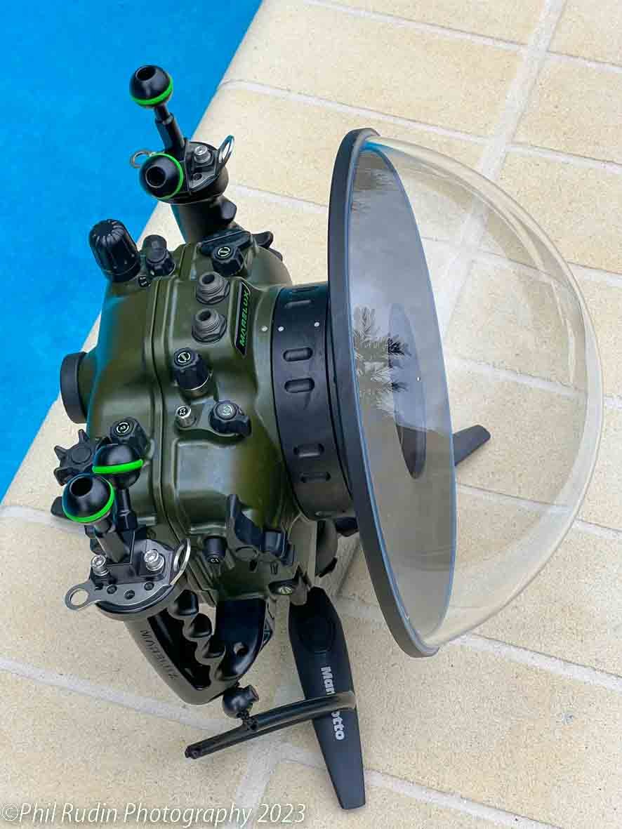

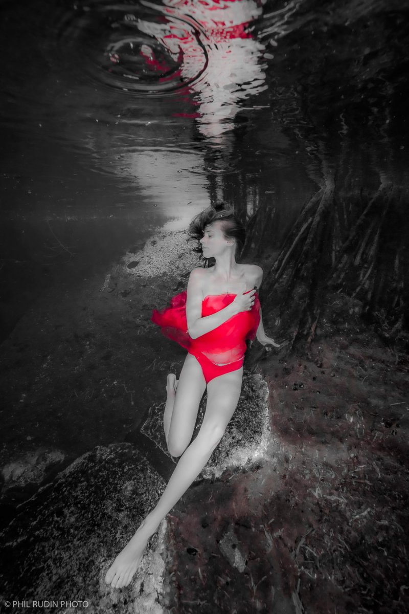

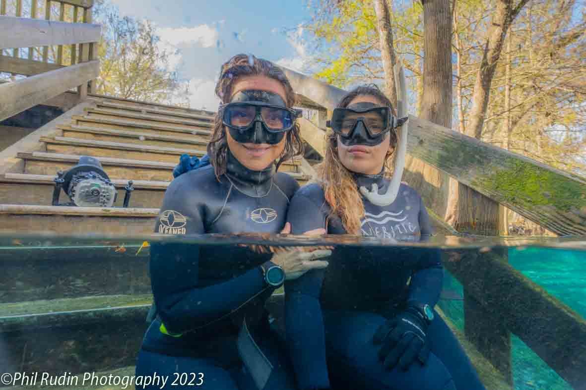

  9. The problem with the very large mostly acrylic domes in the 16 to 18 inch range is that you need to add weights to control the dome just to get it half way under the water, going all the way under is much worse. The 12 inch size can be handled without needing to add weight to the port. Many of these ports like the Matty Smith Photo brand are rated to a maximum of two meters which is great for working at or near the surface but not really designed for SCUBA at all. I am sure the New Sony 2-70mm will work well with optical glass ports in the 180 to 230mm range depending on your tolerance for corner sharpness. Most fashion and portrait work is done with defocused backgrounds so this will only be an issue for some images. Longer portrait lenses like the Sony 90mm F/2.8 macro and Rokinon AF 135mm F/1.8 for FE mount would both work well from behind a flat port. Both of these lenses fit into the same macro port. For me the 20 to 24mm range is a sweet spot for full body shots.
    Attached is a photo of the Matty Smith 12 inch dome on the Marelux Sony A1 housing and the split of the two women was done with that setup with the Sony FE PZ 16-35mm F/4 at 16mm. The other two shots are done with the Sony FE 12-24mm at 24mm. You can see the distortion of the legs and feet being a bit closer to the camera than the upper body even at 24mm.

    I think it would be fine for pure UW use, however you might struggle to do splits with it if you want infinity focus, plug the numbers into a depth of field calculator and you will see focusing on a virtual image at about 0.35m and infinity is borderline at 20mm.  You can see Phil's final shot is not reaching infinity focus, while the first shot with the 16mm does.  The depth of field calculator shows this as well.
