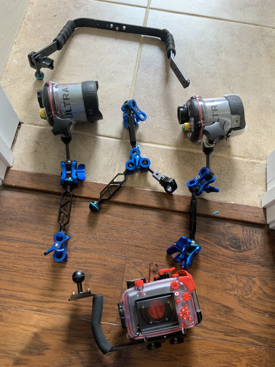

  7. On 2/23/2023 at 2:49 PM, Drshrinkwrap said:
    .  I’m just getting one light.  Maybe ball arms would be better...
    You could get little arms like these, 5 inch ones… That should be fine for using your camera. You can also find a single arm tray. Here’s what I plan to use with the backscatter mf2 (macro only)… a single arm tray that I picked up on AliExpress for $20 or so. That’s where I got the arms and clamps as well, for around 5 bucks a pop plus shipping. I don’t think you’re going to have anywhere near as much trouble with arms and joints than you think. It’s super intuitive and easy to change their position during a diet, especially if you’re using something relatively light weight like the macro wide like they have.
    Edited by diverareyouok
