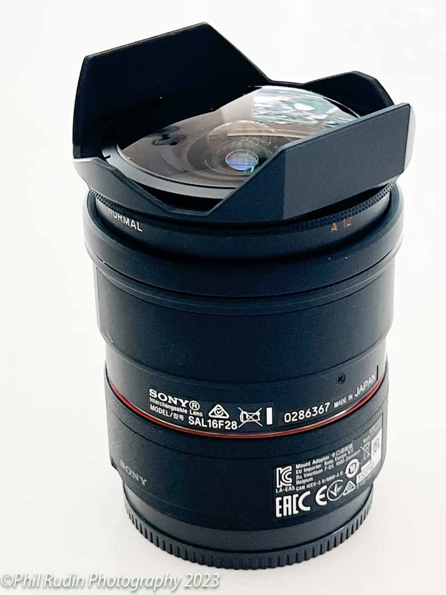

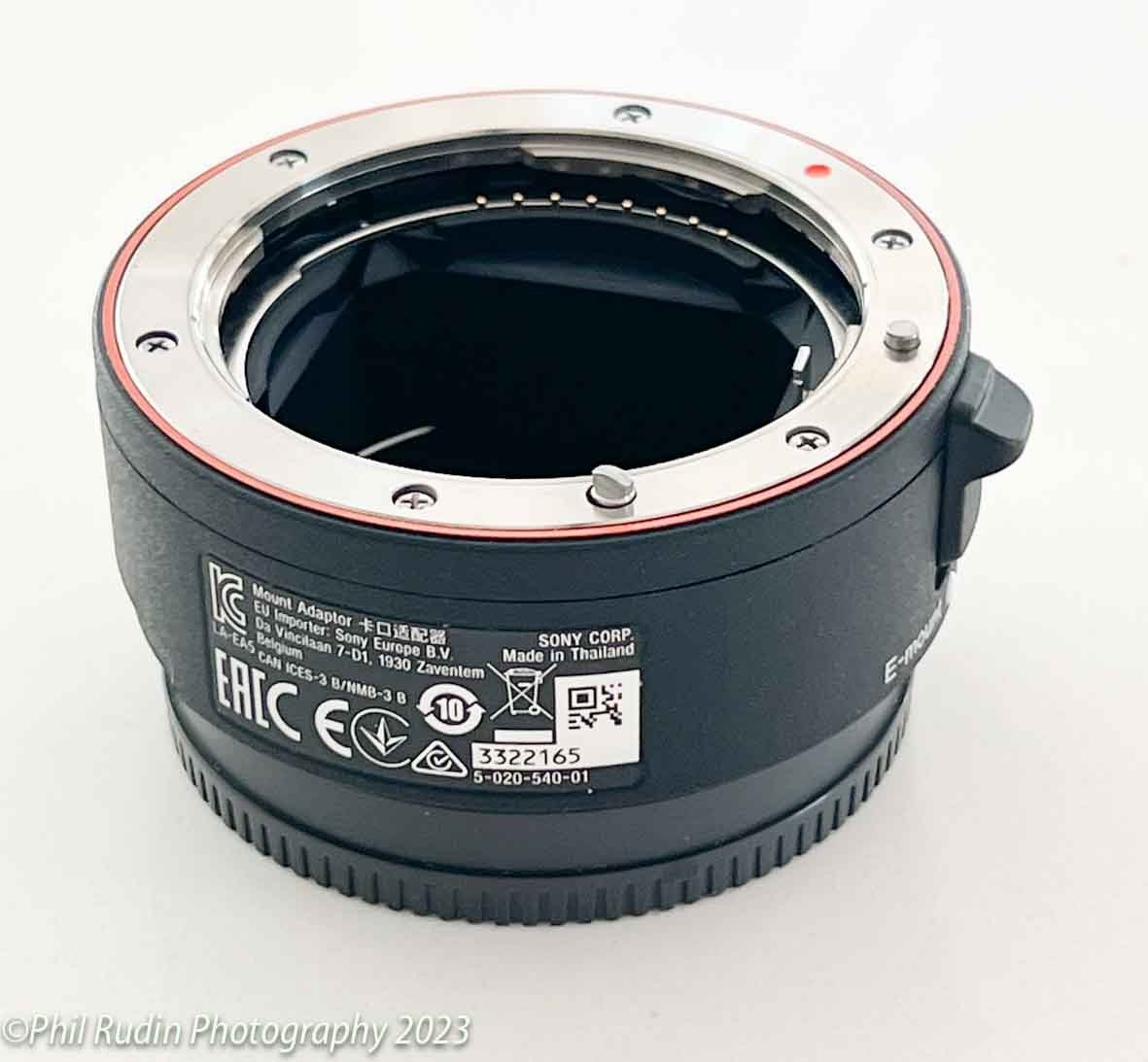

    I would also point out that Sony has already addressed the "big challenge" of developing a screw drive adapter for legacy lenses like the A-mount Sony and Minolta lenses on Sony mirrorless bodies.  I have attached a photo of the adapter and the adapter with the Sony A-mount 16mm F/2.8 fisheye lens. Like the Nikonos 15mm the problem with the wider lenses is that they don't focus as close as modern lenses. The Sony 16mm fisheye focuses to 20cm while the Canon 8-15mm fisheye focuses to 15cm this is a huge difference when it comes to fisheye lenses.
