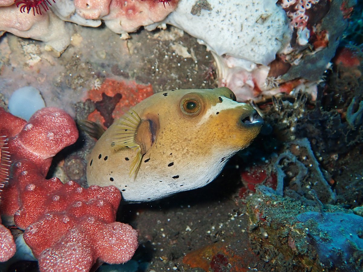

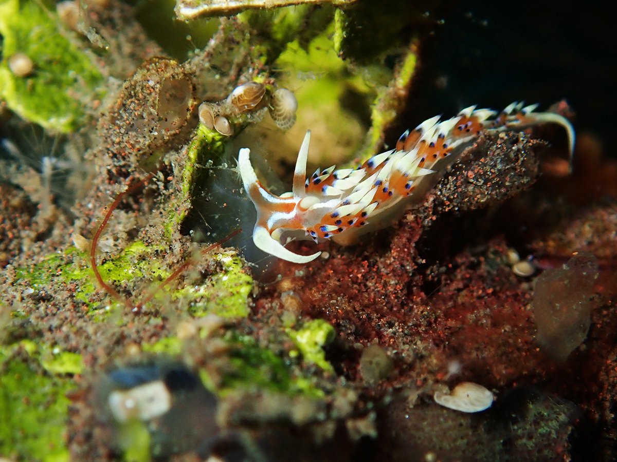

  3. Another option to consider it waiting to buy.  I have been playing with the TG5 for a bit now while taking a little break from my Nauticam/Canon 7dmkii setup.  Sadly, both of my strobes have died now but it forced me to do the last 2.5 days in Bali with only the TG5.  I'm sorry I can't address your question as honestly I don't know a thing about the RC option, so clearly it isn't an issue for me LOL.  I used my Inons on either ttl or manual (I prefer manual and don't think it's nearly as scary as people believe!)
    The camera alone did a good job on nudibranchs, shrimps and other small critters.  It also did a pretty respectable job with larger/wider scenes.  Two images attached.  Of course, adding an external light source is great, but I'd say don't rush and don't put off getting in there and using it on its own.
