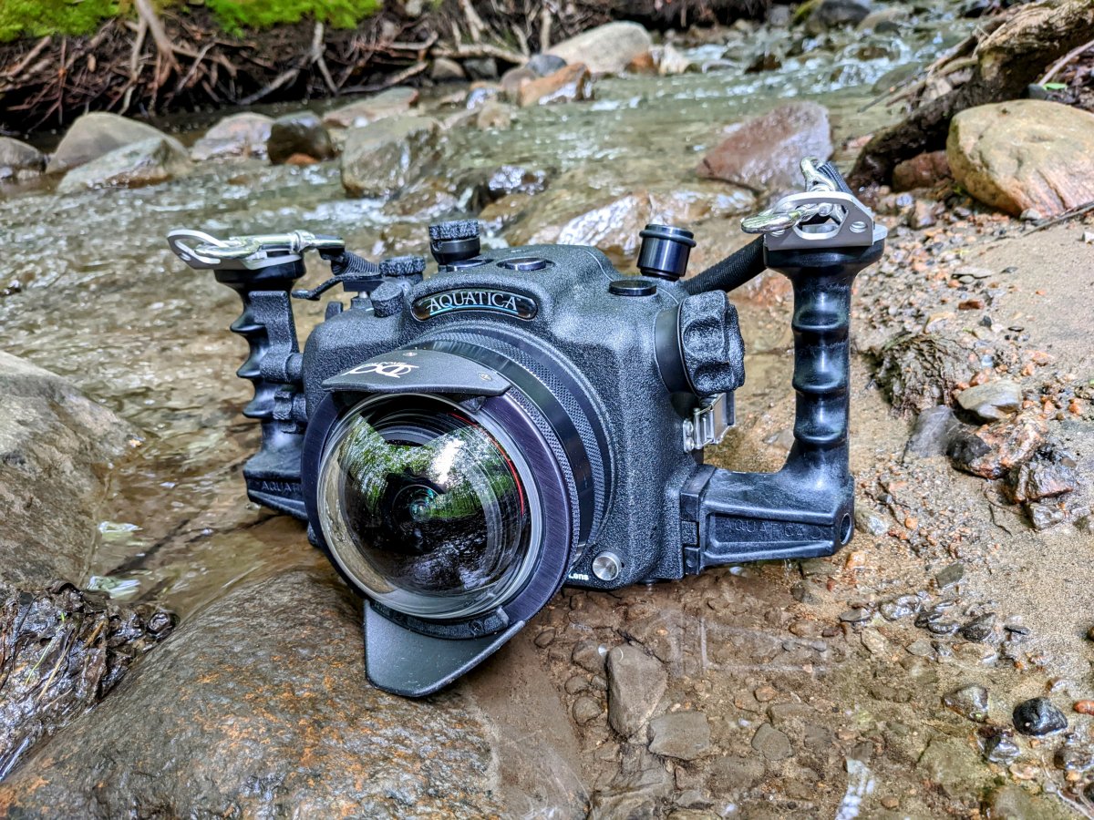

  1. Just read it and give nice information! What about using adapted 100mm glass dome from Aquatica or a Zen with native Nauticam system?
    The Zen Dp100 is compatible with the canon 8-15mm through a dedicated version. Aquatica I do not know.
    The 4.33" fits perfectly the N120 system the DP100 would go in the ring if it makes sense
    I was shown a picture of the actual glass of the DP100 and the 4.33" you need to consider that the diameter given is the outer not the inner so in reality the DP100 is only 8.2 cm which is the smallest possible option for the Canon 8-15mm
    The zen will get you another 7.5mm closer but you will be worried of scratching the glass this is the reason why for CFWA I prefer acrylic
  3. The Aquatica mini dome is also compatible with the 8-15mm, this is the combo I use with my A7III.
