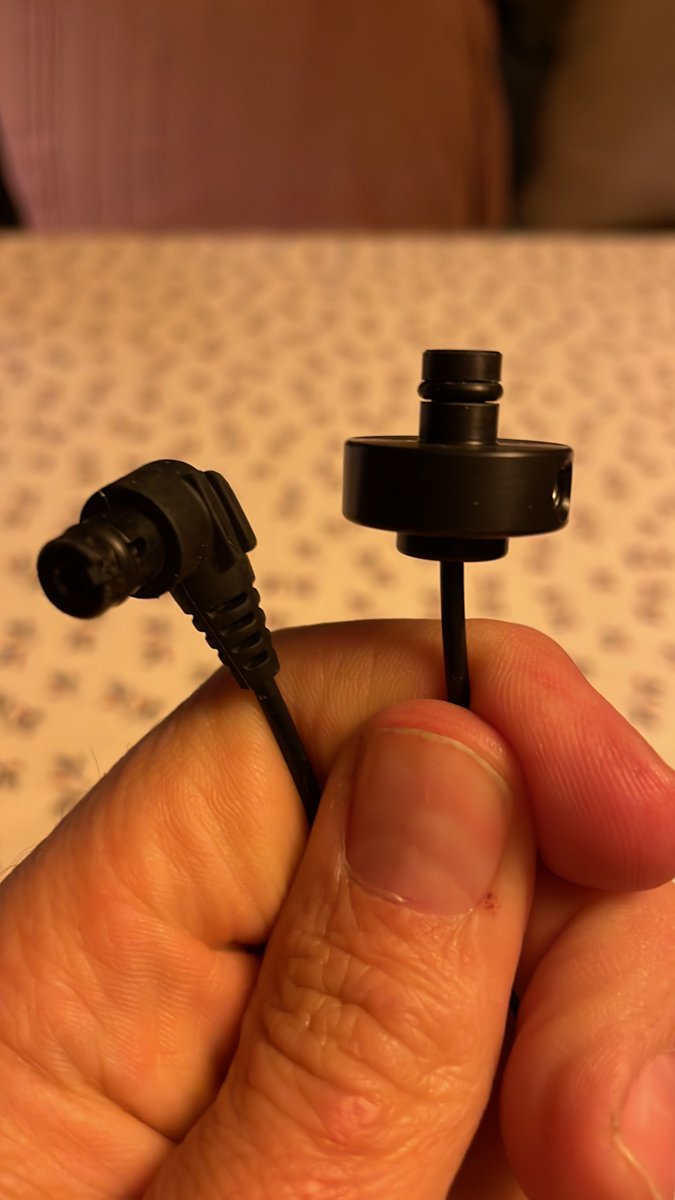

    There seems to be an issue when trying to trigger a non-Retra strobe with the E-Opto converter, depending on the fiber optic cable used between the converter and the strobe.
    After I finished the first post, test with whom I "luckily" used the Mini-Flash's own fiber optic cable, I decided to dive the strobe using Retra's own fiber optic cable, basically because it is a bit shorter and I thought it would be less disturbing. And, oh surprise!, the strobe stopped triggering.
    Retra's quick answer to my inquiry was, as expected. "The issue might be due to insufficient sensitivity of the optical sensors on the strobes. As mentioned we guarantee compatibility of the E-Opto converter only with Retra Flash."
    My second test was changing the fiber optic cable, to see if there could be any difference, and after testing several of them, the third did trigger the strobe. It was Backscatter's Universal Fiber optic cable. Also Ikelite's fiber optic cables worked.
    I really don't know if there are differences, maybe the diameter of Retra's fiber optical cable, but the issue seems to be solved. Next step will be testing again the e-Opto underwater, but this time with Backscatters Universal Cable. hope it works.
    Photo attached with Retra's fiber optic cable on the right side, Backscatter's Universal one on the right.
