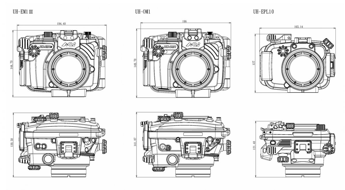

  1. Hi,
    for the ones considering the impact of a potential upgrade, I'd like to share the information I collected.
    1)    UH-EM1III + Flat port : 1022g
    2)    UH-OM1 + Flat port : 1151g
    3)    UH-EPL10 + Flat port : 734g
    My main thinking is that I cannot afford to be proficient with different cameras/lens for land and underwater (ie Sony A7III for land, iphone, somyrx100, and EPL10 for underwater). I'm not practising enough to be good in all this system so I'd like to invest in only one camera system without compromising in compactness.

    On size if the diagram at top is accurate the overall width of the OM-1 housing is more or less the same at 190 wide without handles.  The Nauticam is a bit taller to provide space for the little accessory flash.  The handles on the Nauticam are removable for packing if needed.  I have the EM-1 MkII which is more of less the same size as the OM-1 and can pack the housing, strobes, lenses and ports into a carry on legal size backpack quite easily.
