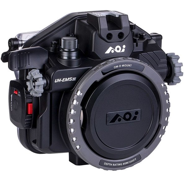

  1. Hello everyone! Im a new member here and have started to create a rig around the Olympus OMD EM5 III
    Im currently looking for a housing for it and based on my research i have 2 options.
    1. AOI Housing
    2. Ikelite housing
    I like how the ikelite housing looks like because its more compact, but it is manual hotshoe to electric sync cord only, which limits my strobe options. I havent read any reviews on this housing so id like to hear the community’s thoughts on it. It would be cool if there was a converter that could allow the use of fiber optic connection for this housing, but I havent found any as of the moment.
    The AOI housing is bigger but allows the use of fiber optic connection for TTL strobes (like the Backscatter MF2). It’s also a little cheaper relative to what features its offering compared to the ikelite.
    Any thoughts appreciated. Thank you!

  4. Have you considered the AOI for EM1 or OM1 ? they are much smaller..
  5. I would suggest first step is to look at what lenses you might like to use with the camera and confirm if they are supported and if it's a good solution,  For example you can use various wide zooms with ikelite but are limited to a 6" dome port if you wish to zoom.   You could also keep your eye on the classifieds here to see if a Nauticam or Isotta housing come up for sale.

  11. I think one difference is that in Ikelite you need to use a 6 or 8" dome and some vignette while in AOI they have a 4" dome which is better for CFWA and streamlining/travel.
