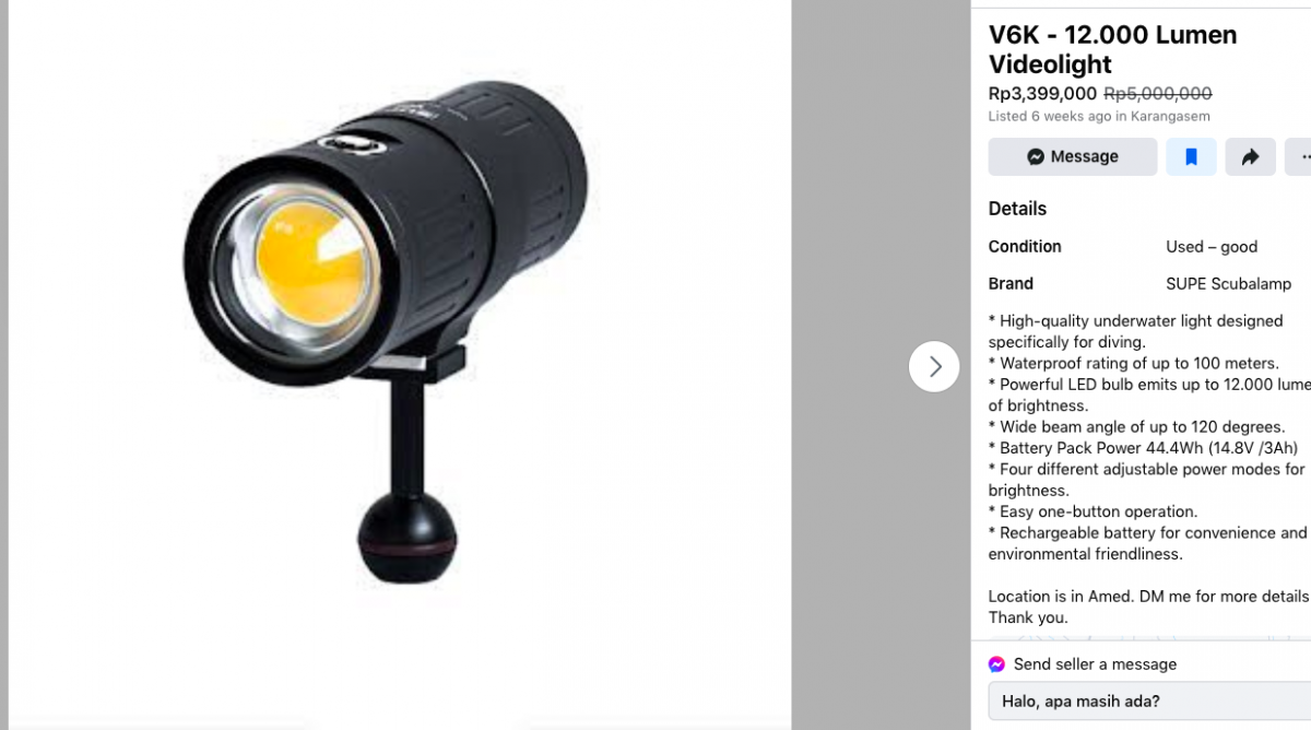

    There's 2 lights for sale on marketplace, one is actually where I'm a "12,000 lumen" Scubalamp at roughly 200 euros, but autonomy is supposed to be really bad as is, and the seller is tellig me it has less than 30 minutes autonomy at full power.... I spent over an hour with my cephalopod buddy yesterday just on the first dive....

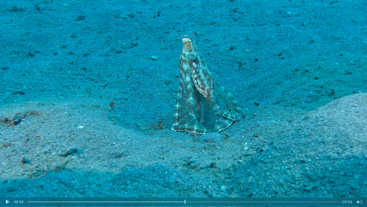

    My mimic-octopus buddy is between 15m and 7m (hole seems to always be at around 15, was for the 5 dives I saw him so far), on a black sandy slope, so not in direct sunlight.

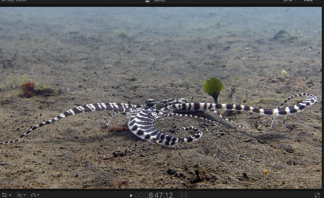

    Here are some raw, non white-balanced captures from yesterday (since I was using lights, I was on AWB, which might not have been the best choice given how weak the lights are...) - I'm basically in ambient light
    Top one is on the plateau at 7m, and bottom one on the slope a 15m - I also did get some shots with a filter and manual WB the other day (not my keldan filter sheet, as I stick it on the lens inside the housing - instead I used an old 55mm UR-Pro Cyan I was using on the GoPro) - it was ok, but for a small guy like this I thing I'd like it to pop a bit.
    Yesterday I tried getting the lights closer, and tried various positions while my pal was just sitting in its hole, but they're just too weak.

    I would suggest first trying a custom white balance, I had a quick look at your first image and even from a screen shot it somewhat correctable, which suggests it might improve things with your current lights.  The issue of battery life for the new lights could always be dealt with by only turning them on when filming perhaps and they may even be bright enough at half power which also extends battery life.

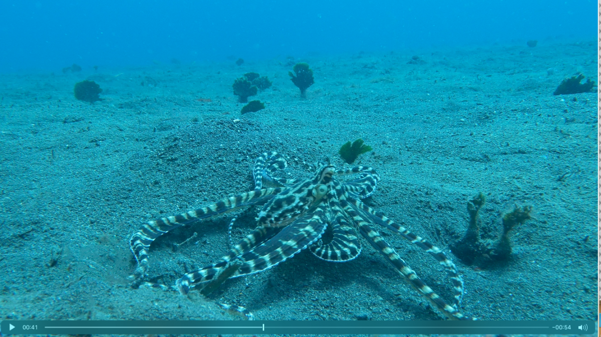

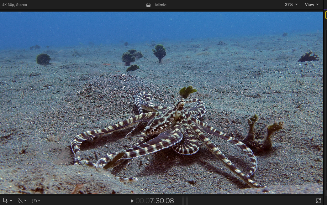

    Thanks Chris - yeah, I should have tried manual white balance - underwater it looked like the lights where having more of an effect than they do in the resulting footage... Also looking back at previous footage, it seemed like it worked better when I had the two lights bundled togeter than closer to the subject, but on the sides.
    i took a quick look in post, and by rebalancing the WB, I can get an ambient light look, but it would have been better with a fllter.
    The first image is AWB no filter, with the two 1000 lm lights, rebalanced in post.
    the second is shot a few days earlier, ambient light, manual white balance with a UR-Pro Cyan filter
    Same area / depth, I prefer the second one when it comes to that ambient light look... More accurate whites and colour balance in general - but then again, for the first one, I didn't WB underwater, which would have been better given how much ambient light was there...
    Humm, probably a dead battery. If the price is good you can just replace the battery pack.
