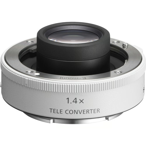

    Kenko teleconverters are only available in Canon EF mount and Nikon F mount. If you want to use a teleconverter with a Sony E-mount lens, Sony is the only game in town, but it has an element which protrudes into the lens:
    Most telephoto lenses have the hollow space inside to fit this element, but the 90mm macro doesn't.
    If you want to use a teleconverter with a macro lens on a Sony camera, you need to use a Canon 100mm or something similar.

    Right, that does limit you a bit if you want to do better than the 2.3x or so you can get with the SMC-1
