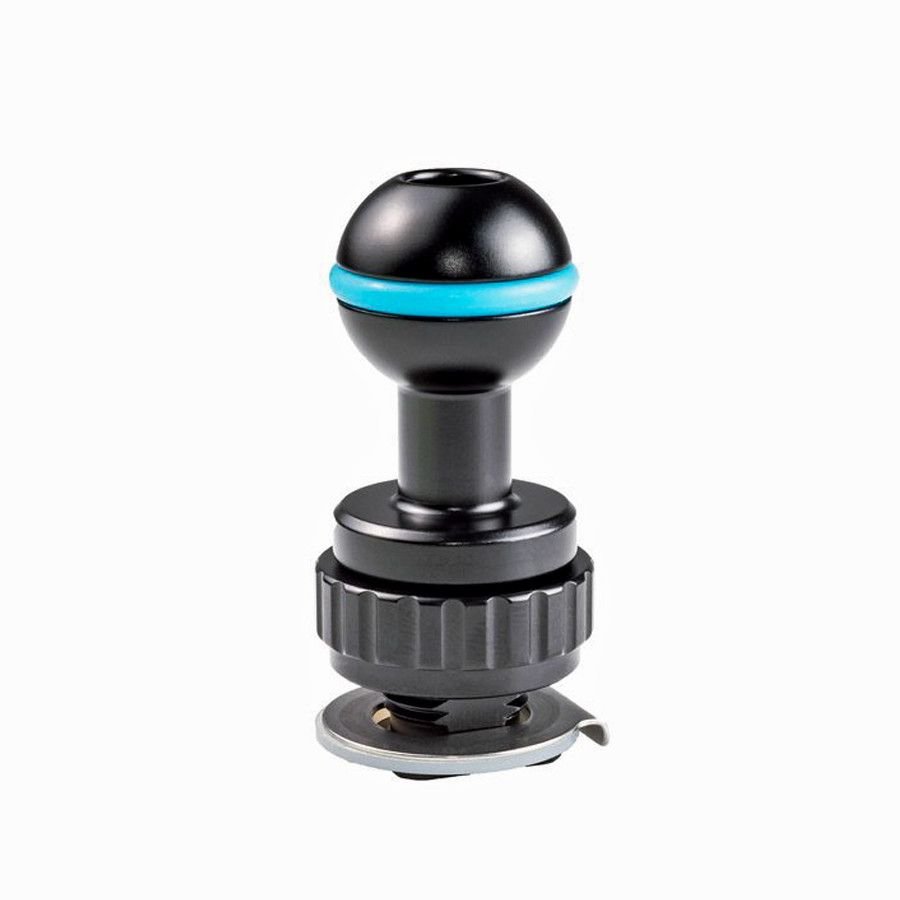

  4. No problem with this shoe mount (since I rightly fitted the metal in the groove  :-) ). Just check the rotating ring now and then.
    This looks interesting except it way down the port and the light is negative so it creates even more torque

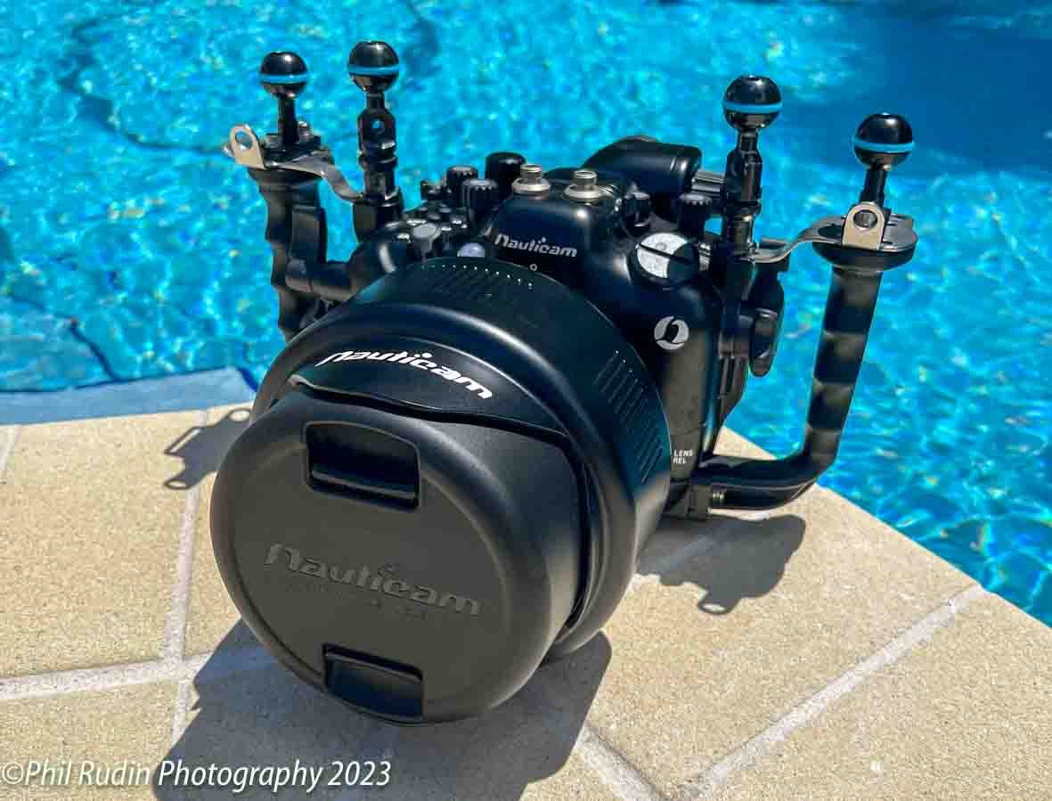

  8. This is an A1 housing and also works using the M10 mounts provided. I use the extra balls to mount lights, the sending unit for a ring flash and more.

    Anyway I found the solution M5 mounting ball to replace the M5 screws that fix the handle bridge all sorted going to put two of those
    Thanks Phil. Will got for two M5 one each side
