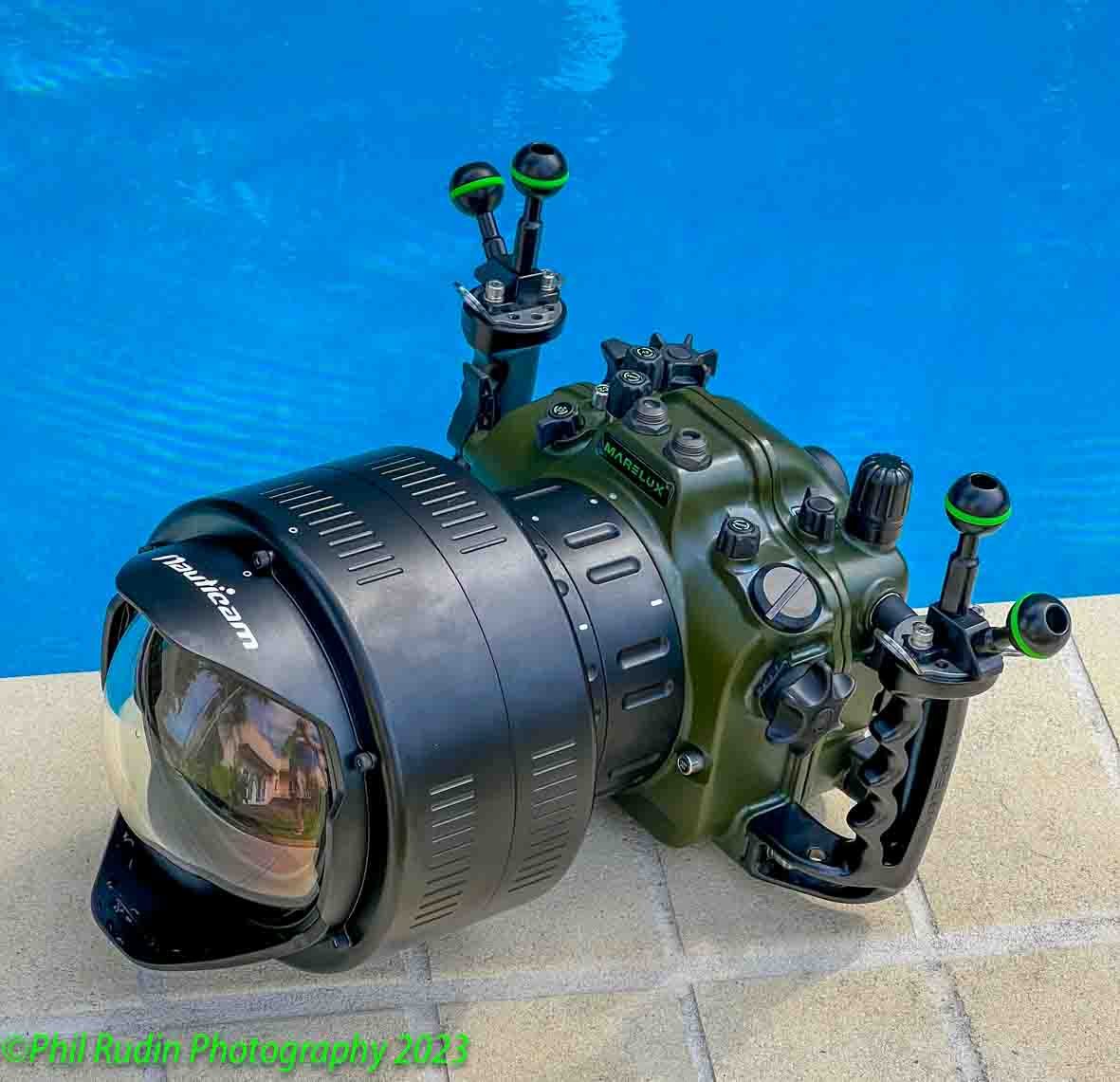

  5. The Tamron 28-75 G II is better but still bumps. If you want full 130 coverage at 28mm you need about 60mm of extension on a Marelux housing which you can convert for Nauticam extensions. At 65mm of extension the lens vignettes at 28mm and at 55mm it just bumps sooner.  With 60mm the G II version will zoom from 28 to 56mm where it stops by bumping the back of WACP-1. So not a bad range at all V. the old version if you can make a zoom gear fit. It appears that this lens may also work in about the same zoom range with WACP-C but I don't have an adapter for N100 to Marelux to try that theory.
