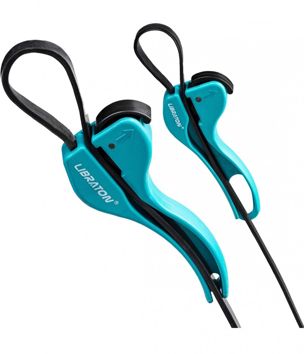

  4. It happened to me a few weeks ago and I solved in a minute.
    I used a band wrench usually used to unscrew oil filters. I bought I on Amazon.1319341035_Screenshot_20230401_135309_AmazonShopping.thumb.jpg.4050b8dbeb84f34a4d465cd061bcae22.jpg
    Little tip: insert the port on the housing because the wrench works better.

  13. The talk about coatings is interesting, but believe me that no matter how impressive the filter wrench is, it is the kindest option.
    My CMC and adapter seemed to be welded together. I tried everything to no avail and then with the filter wrench they unscrewed like butter.
    As I said, the only caution is to have it mounted on the housing so that it stays perfectly still and you can apply a tangential force to the center of the port.

  15. well, i got a cheap strap wrench and torqued it as hard as the rubber strap would grip the CMC, and no luck.  Then I put the whole thing in an ultrasonic cleaner with just water (with an hour soak between two 8 minute cycles).  Then I used the strap wrench again and it still took a lot of force but it came off with no damage to anything.
    So I definitely like the strap wrench idea and I really have no idea if the ultrasonic cleaner helped.
