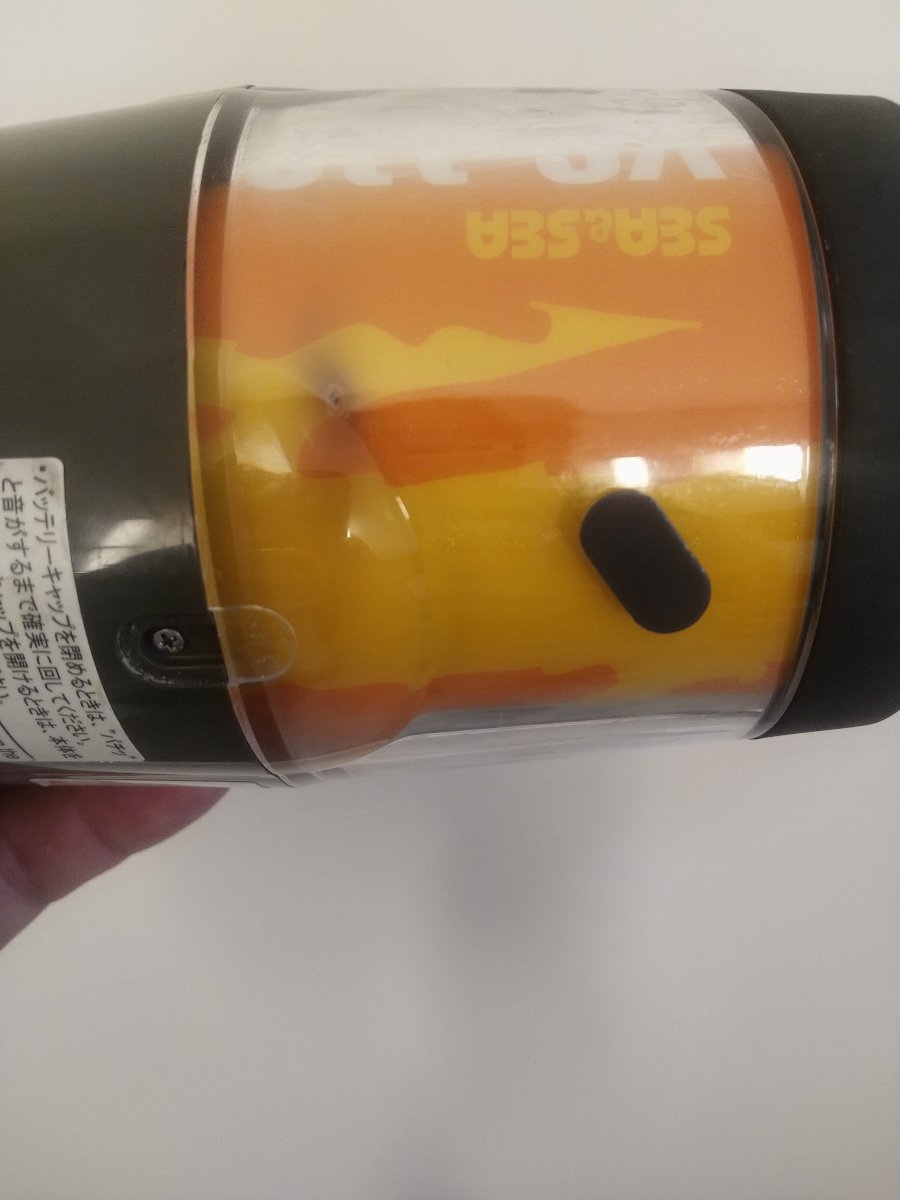

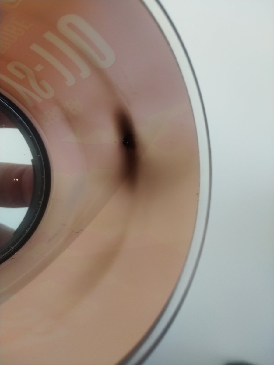

    They are simple to take apart (3 peel offs over 3 screws). Before that I suggest carefully examining the body looking for a small pin hole sized black scorch mark somewhere on the body barrel. I have one like that...

  4. Let us know what you find out. I have one that "burnt" one of its semiconductors which left a small scorch mark visible from the outside of the body. I had to look closely to see the small scorch mark from the outside.  Much more burnt bits inside. I am passively waiting for a donor unit to fall in my lap so that I can have a full pair.

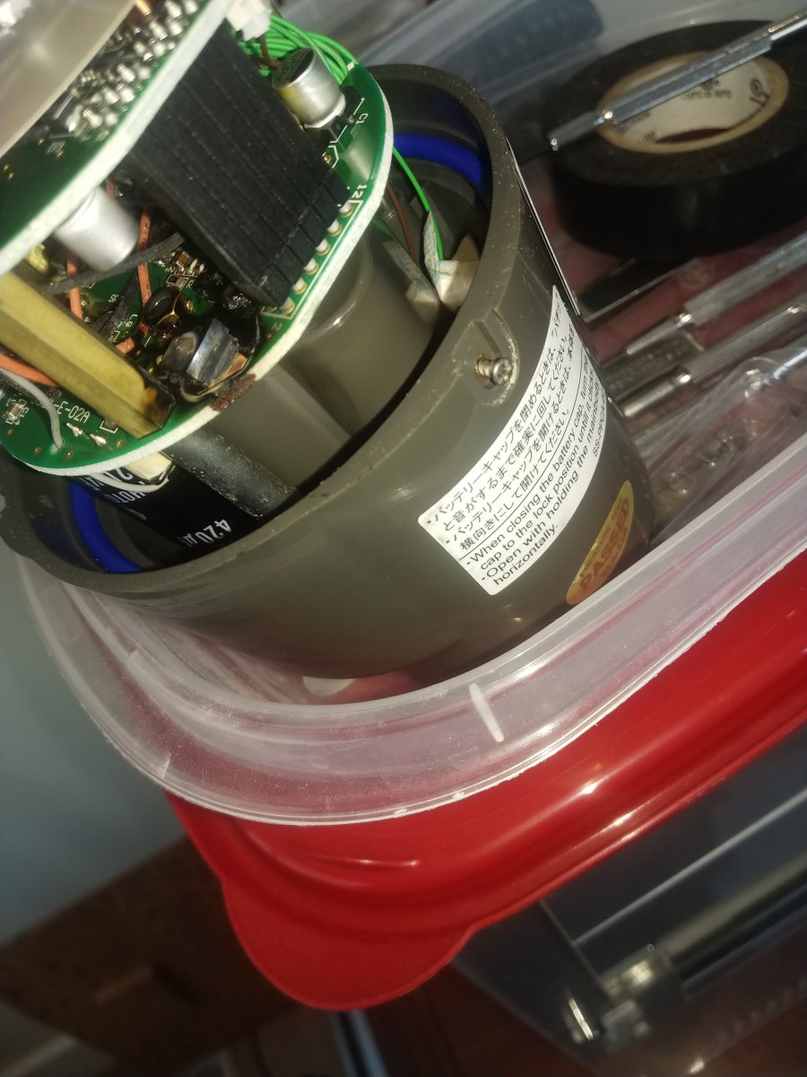

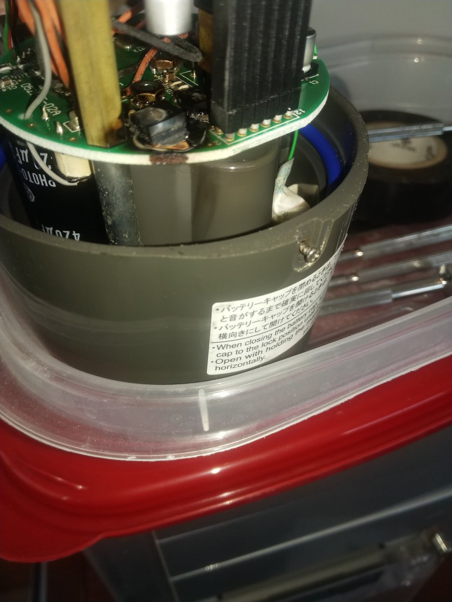

  7. Got the strobe opened up and this is the only damage I can see (small slightly brown discolouration) which is right below the yellow transformer
    ……I thought the yellow transformer would have shown signs of melt down as I have no power, but it looks ok (obviously could still have failed). If anyone has any ideas, I am all ears. Thank you!a9e467d630e7d61c451a5136ec06524d.jpg
  8. I have opened several non-working strobes, looking for a way to fix them,  and found that the circuits are so complex as to be undiagnosable, and unfixable. Just recently, one of my Inon strobes half way flashed, then quit working, no damage to be seen in the circuits, maybe the main capacitor or the xenon tube failed.
    I have looked for a repair person or shop to fix a defective strobe, but have been unable to find one.
    Moral of the story:  It may be underwater strobes cannot be repaired.

    My unit has a small visible burn mark on the outer body. Inside it looks like one of those "3 legged transistors" has fried itslef.
  13. My unit has a small visible burn mark on the outer body. Inside it looks like one of those "3 legged transistors" has fried itslef.
    Thanks for sharing. I had mine into a local electronica guy, he tested it, and even though I don’t have much of a burn, I’ve got multiple components that are fried on both boards.

    Mine looks like a single component has burnt. No burn marks on the bottom side of the board, but lots of black topside all around the component.
    I have not yet investigated repair. Maybe all I need is a simple part swap? I have no idea what the part is or how to source a replacement (other than removing it from another strobe).
