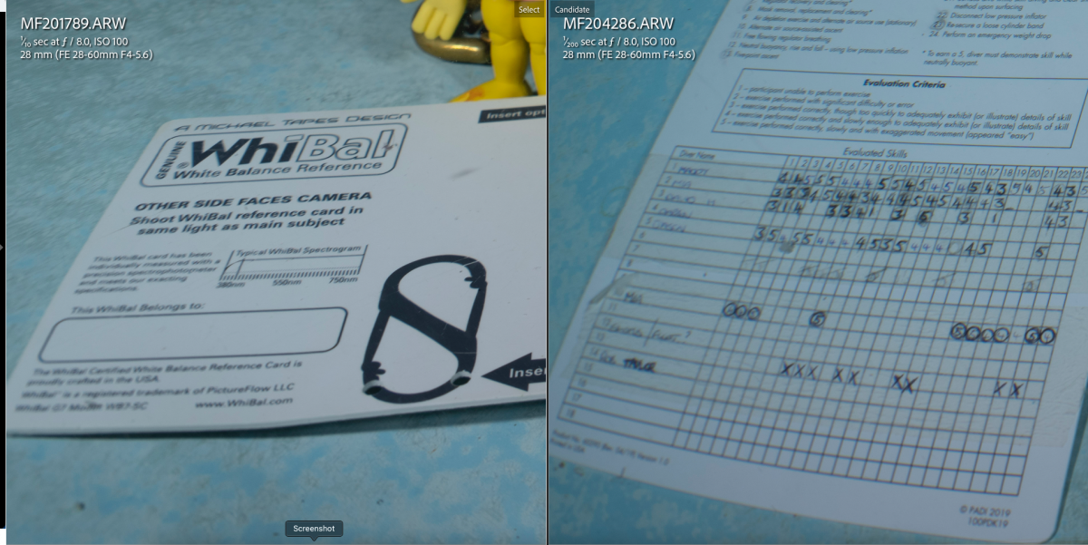

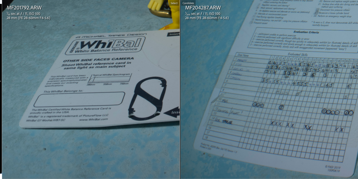

  4. Some examples of edge sharpness with Sony 28-60mm
    No difference that I can see the WWL-1 shot is closer so harder situation
    WWL left WACP-C right
