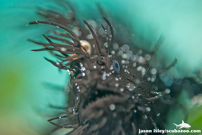

    Here's an example of a Jason Isley's Zeiss Tessar 50mm shot:

  2. You could start off by looking for older triplet lenses. The most famous of these is the 1890s Cooke Triplet which was produced by Taylor, Taylor and Hobson. The problem you will find is that most were built for larger format cameras and have long focal lengths, however some, especially lenses intended for use on stereo cameras are of shorter focal length, and many even earlier lenses have optical flaws which can deliver interesting backgrounds. Central definition can be good but won't be up to modern standards.
    The earliest lens I've used underwater is actually an 1865 Grubb (Dublin) Stereo Doublet (~3.5" focal length) ,which delivers surprisingly sharp central definition but falls off rapidly and has 'soft' bokeh and highlight 'bleed'. But these are escalating in price too, especially the stereo copies. If you can find shorter focal length lenses from Victorian times from makers such as Ross, Dallmeyer, etc, then, if cheap enough, they are well worth trying out. Many will use non-standard mounting threads (many are odd imperial threads - the Grubbs use fine Whitworth threads for example), but can be fitted into soft plastic mounting board easily enough and then adapted to whatever mount you use with a bit of ingenuity.
    Later lenses are worth trying too and 35mm lenses from the 1930s work well (but many won't easily adapt to a Nikon dSLR as their rear focus is physically too short). You could try looking for (Leica) visoflex fitting lenses though as these should adapt. They will be optically better than Victorian lenses but not perfect.
