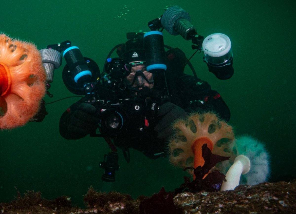

  5. Other's may have better idea, but this works for me here in Puget Sound, which means thick dry gloves. Camera is A7C with NA housing. I have one bayonet holder on the right float arm, this is used to store WWL-1B. On the same housing post, I have a triple clamp with another bayonet holder at the end of that arm. You can see both below. I find I need both as handling one while swapping the other is challenging with the gloves. I suppose you can put both on the float, but having both face me seems to work out with the swapping. To make things quicker, I've also put a silver registration mark (silver sharpie) where the lens matches up with the blue holder latch, which avoids fussing with the lens too much. Note, This is just slightly negative, and since I carry the camera with right hand, I don't notice any balance awkwardness.
