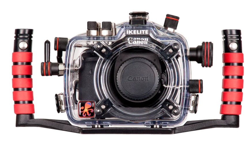

    It definitely does, I first used this strobe with a point and shoot camera with a velcro mask to attach the fiber optic cable. This strobe is now dead. Im wondering about a new strobe to use with my housing for my DSLR (ikelite 200FL).
    This housing does not allow the built in camera flash to pop up (no room), and I can only use the hot shoe on the camera. I don't know how I would use any slave triggered strobe with this housing? Which makes me think I need to look for a new strobe that has a sync cable. Am I mistaken, and there is a way for this housing to work with a fiber optic cable? Also, isnt this going backwards in terms of flash control? By that I mean, manually having to set strobe output vs having the camera set strobe output (TTL)? Sorry for all the questions.

  8. The ikelite TTL modules I thought were quite specific ikelite strobes and the TTL worked reasonably well, plus the inside housing TTL modules were quite reliable as were their strobes
    If you go to other strobes like the INON, it will be manual only unless you use a fibre optic, but you need something to trigger the strobe, there won't be enough space probably to open the built in flash on board so you'd probably need a strobe trigger.  There may be some specialty options that connect to a Canon body with TTL.
    The path of least resistance is probably an ikelite strobe, though they are quite big and bulky.  The DS-51 is an option though as you say is slow to recycle.
  9. I have had a number of Ike housings over the years. I have DS50, DS51 and DS125 strobes as well as a YS110a. As far as I know your 110 was not functioning in TTL mode. Ikelite TTL circuitry only works with Ikelite strobes. My guess is you were just getting, for lack of a better term, luck with your strobe set up. I have found the Ikelite TTL to work well with their strobes.  Yes they are a bit heavier and probably larger than other brands.  The larger strobes also use a proprietary rechargeable battery which is maybe not as convenient as the AAs that most use. But they do last a good amount of time.
    If you want to go with a fiber optic set up I would suggest talking to Ikelite about their item 44700 Manual fiber optic transmitter. But this is pretty expensive for just a manual flash trigger as it doesn't provide any TTL functionality. It also just lists DL or DLM housings but I don't see any reason it wouldn't work with your FL housing.
